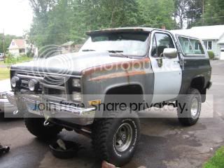

My glass hood was in the back yard a few years and worped so I removed the skin from a stock hood and removed the inner structure from the glass hood and glued it to the steel frame.It fits like the original hood and functions like it also.

It takes a little getting used to because its in your sight path but it makes the truck look meaner and the heat pours out cooling the engine better.It was allot of work doing what I did because after I removed the framing from the glass hood all the resin needed to be grinded off to make the skin sit right on the steel frame but it was worth the work.
