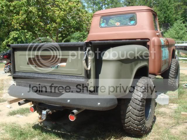

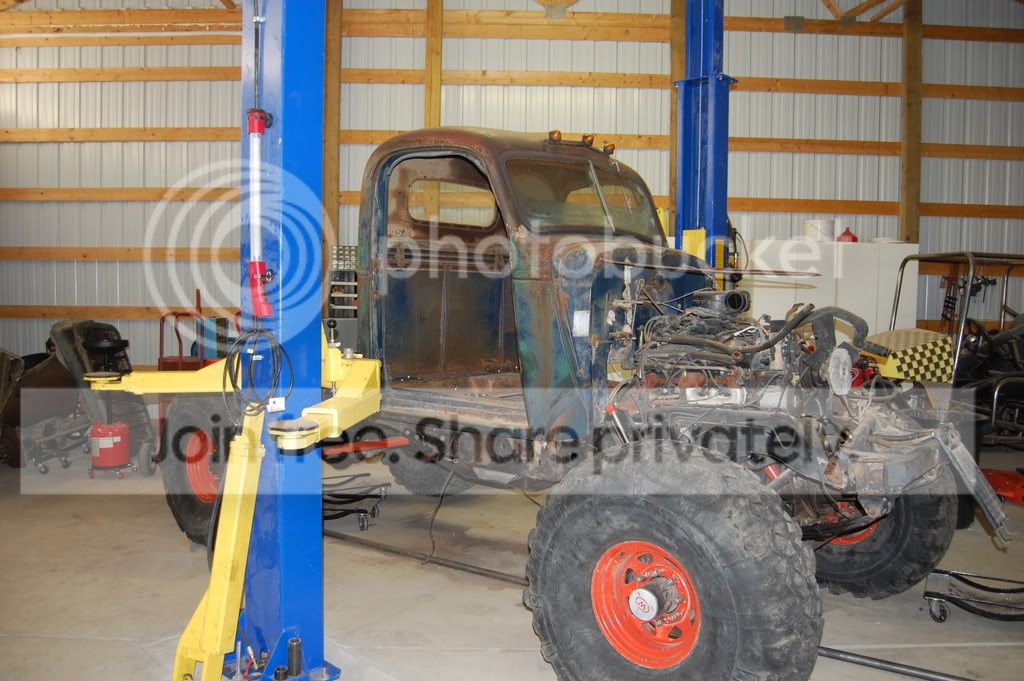

kind of like this?
before.
Today
they were napcos, i has one :D

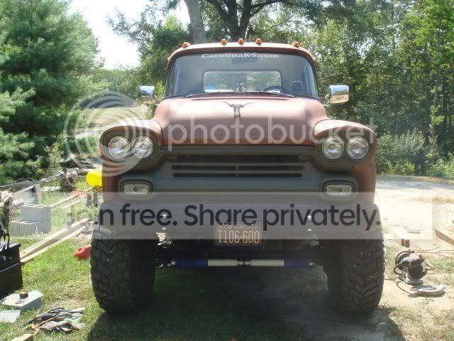

I would just adapt the newer axles to the current frame rather than go the other way. just my opinion. I have pictures of my stock napcos drivetrain, but i think your gonna go with a married t case rather than a divorced like it had.
User name 58 apache, as the user name suggests, 58 apache on a 4x4 frame on 37s, saw it in person it was badass
