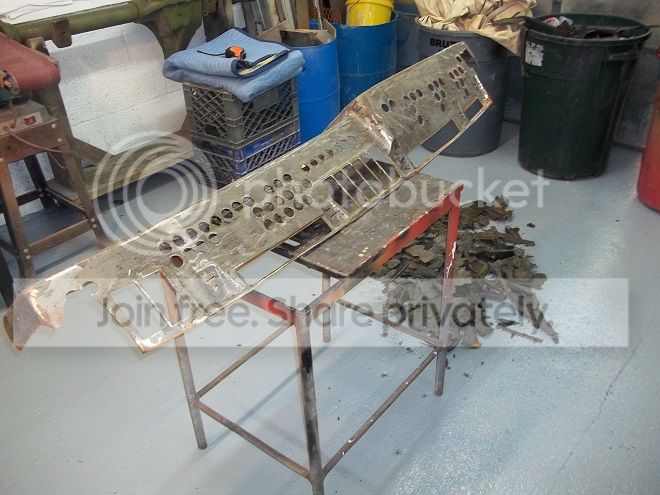

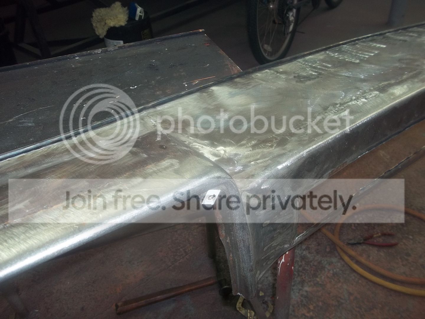

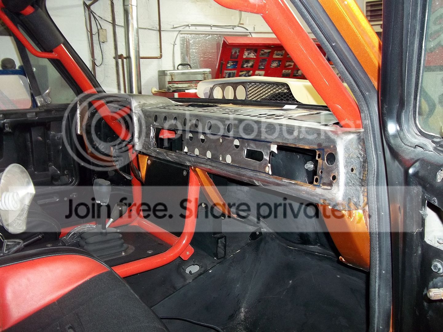

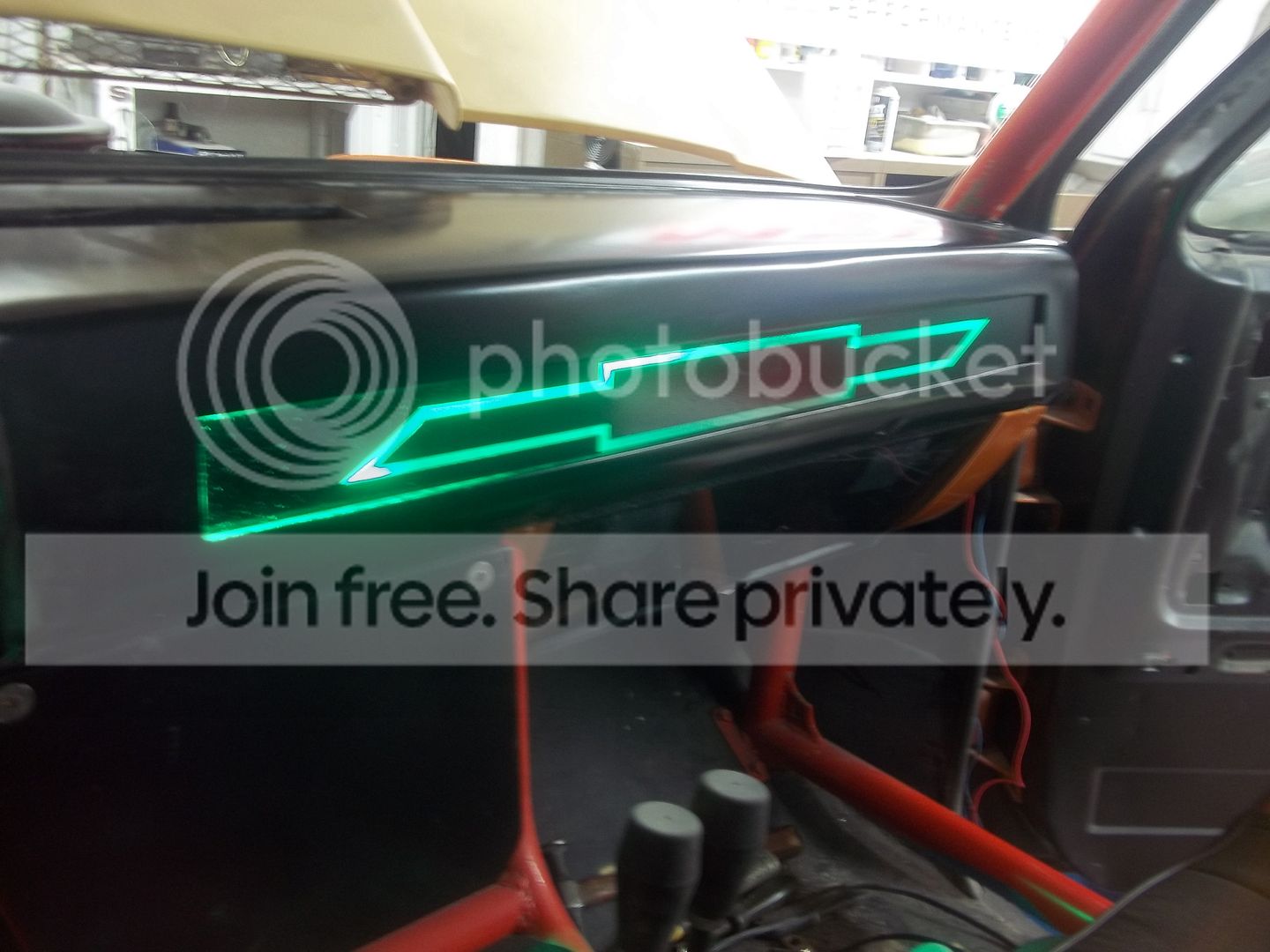

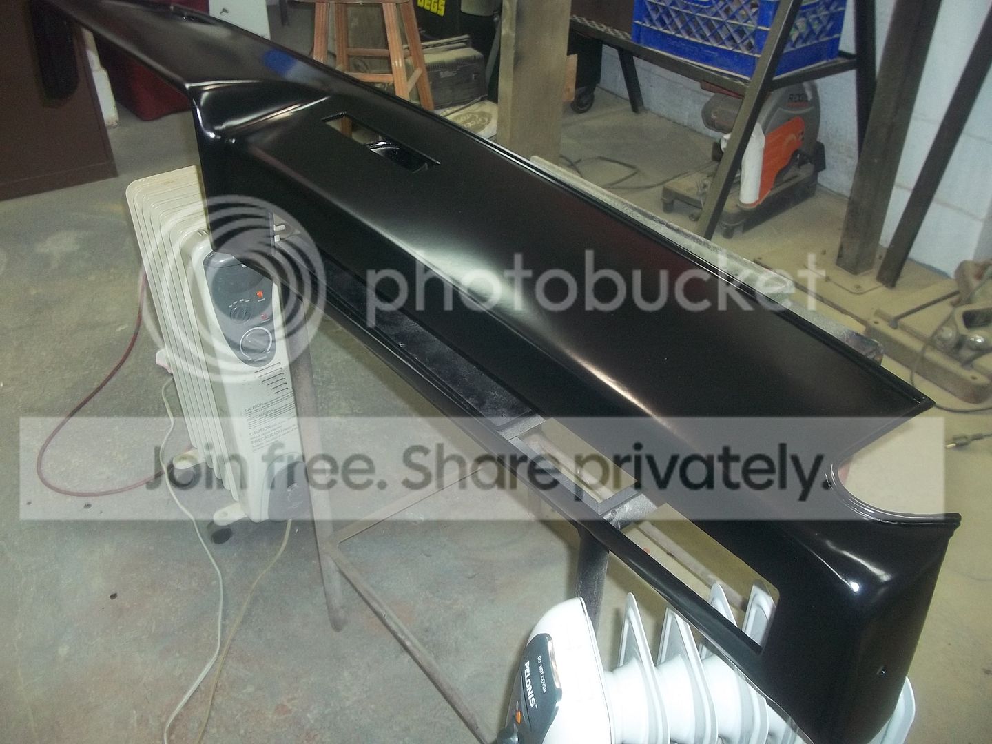

well, it's a relatively big ordeal due to all the holes in the metal from the factory for the dash foam to "bite" to...
mines pretty heavily modded with the lexan window and the round rod at the back edges...
just the metal, is a bit flimsy.. the round rod really stiffened it up.. but the major hurdle are the holes... some guys'll hack a quickie with a fiberglass layer, or even alum tape on the backsides...
but to do it reasonably right, it's a fairly involved project on the sec gens...
couple pics...
couple pics...
