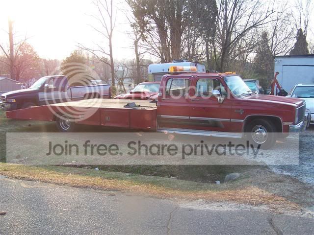

Will this,
haul this K5 (soon to be d60/14bff too).............
.............relatively long distances safely?

I'm looking at buying the car hauler, but wanna make sure it'll be heavy duty enough! :wink1:

The Blazer might fit on the bed of that thing, but it is going to be severely overweight, at least as far as the DMV is concerned. That is a C30, I can't imagine your rated payload to be more than 5K, if even that. That bed has to weigh a grand or so.
Will the truck handle it? Perhaps, with some stout overloads. I don't think I'd do it though, a K5 with big tires and 1-tons is going to be around 6K.
It may be a handful. And you're going to run into liability issues if you ever have an accident. Brakes will be marginal at best.

My dually is rated at 10001 GVWR and weighs 7200 by itself. That leaves only 2800 for the load. If the red dually pictured is rated at 12k (high guess) and weighs 8k (guess again) that would leave 4k for your rig.
That is still too small of a tow rig.
Also, the K5 would be waaaay up in the airstream severly limiting speed and mileage.
I just can't imagine that the truck in the picture would be that great for hauling around a 6k lb. Blazer. As already stated this truck, before it was converted to a car hauler, probably only had a GVW rating of 10-12k and I would guess weighs at least 8k as-is.
My biggest concern would be handling and the brakes. While the suspension may have been upgraded some, I doubt the brakes are any different than a stock 1-ton.
Anyone have any experience with these car haulers? How does it differ from the "roll backs" so popular today? That is, as far as weight and all. I've seen some hauling full size 4X4 trucks and they sit a lot higher and look like the same axles.

I think your brakes will be fine. I'd change all the brake lines over though to Stainless steel- just a bit of insurance, and also switch to the DOT 5 (synth, but dot 3 compatible) fluids, with a full bleed. Much higher boiling point.
Some really good front pads (might even want something like a semi carbon/kevlar based one).
Oh yeah, and add airbags for the back. you'll definately need it.
Other than that, go for it. Aerodynamics wont be that bad, think about it like pulling a 5th wheel. If you have the money, you could also consider swapping to 19.5" wheels. They have a significant margin of weight carrying capability (rickson wheels, for one manufacturer).
find out what the GVW is of the hauler, then weigh it. now weigh your blazer. if the total actual weights of both rigs equals more then the GVW of the hauler then do not bother. it may stop, steer and accelerate fine enough for you but the first weigh station you roll through is going to be a nightmare if you are overweight.
