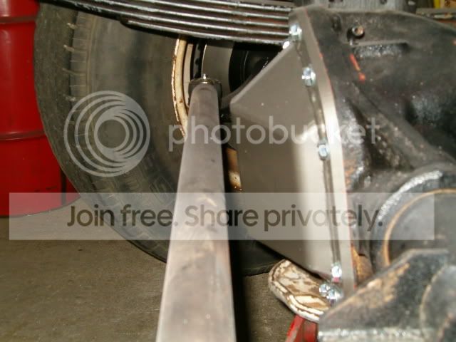

DIY4X 3/8 flatback cover w/ ORD 1.5x.375 wall tie rod.
I have not run this combo yet, this is in the shop still:
turn to the left:

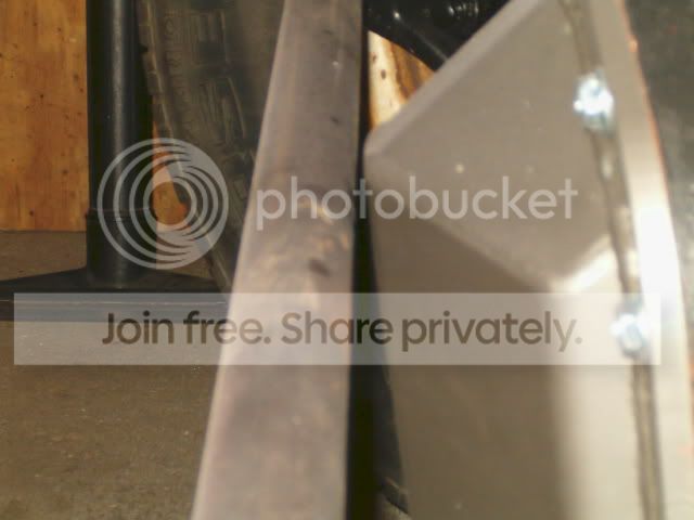

turn to the right (3/8" gap between the cover and tierod):
The Razorback will fit with a large tie rod but you have to specify you want a front cover when ordering. Flat back fits no problem.
Yep I run a Razorback with tabs for hydro assit and ORD 1.5 rod, everything fits fine. Ive beaten the hell out of both, still holding strong!
I'm running a 1.5" tie rod in stock location along with one of Ruffstuffs THICK covers and in one direction the tie rod is VERY CLOSE but doesn't touch the cover.
i run the GLO cover, and i believe my tie-rod is only 1.25" dia tubing. Anyways, i had to set my stops on my knuckles so the tie rod doesnt plow into the cover, otherwise it would most definitely hit. I will confirm my measurements tonight for you.
I have a ruff stuff cover and 1.5" tierod. Bent the crap out of my tierod last weekend and it got into it and twisted up my ram all goofy. Pressed tierod back straightish for now till dual ended ram gets put in.
