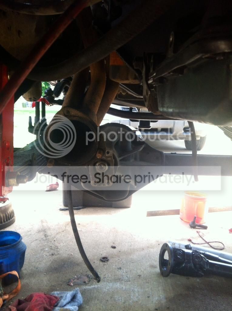

After swapping in a HP Dana 60 front end, my long tube headers are now in the way of the front driveshaft, therefore I either need short headers (aka: shorties). I'm running true dual exhaust with two flow masters on a 350 (est. 300 hp).

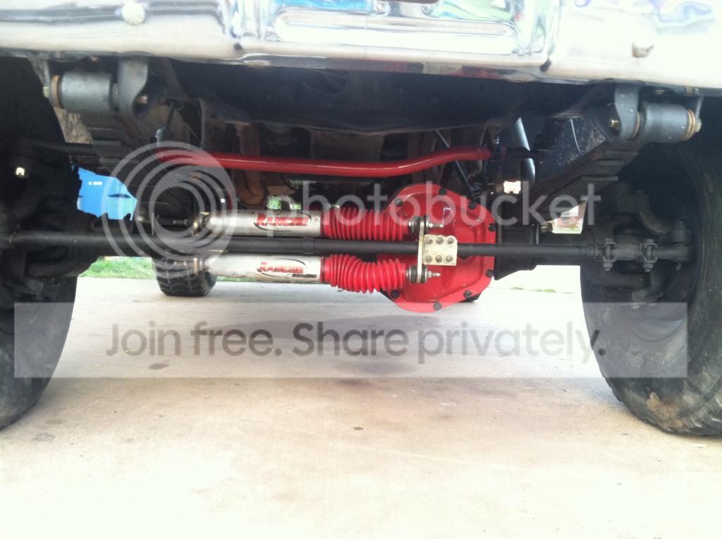

Those Headman 69830 might work, but I don't see any info on how far down they hang. That's why I was asking about the ones that simply replace the stock manifolds. The issue is that my front pinion is 3" higher than a GM D60 and the differential is on the drivers side. Standard long tube headers are designed to clear the driveshaft on the passenger side, and 3" lower (at the pinion).
My front drive shaft will be almost parallel with the ground.
Really I just wanted to know if it's worth the money or the trouble to get short headers (like these: http://www.ebay.com/itm/141349047212 )or if I should just put manifolds back on and go with it.
The problem: looking from the front T-case output.
This link work for you? http://coloradok5.com/forums/attachment.php?attachmentid=62229&d=1205104435 About as good a pic as you can get I think for reference. But there are others.
