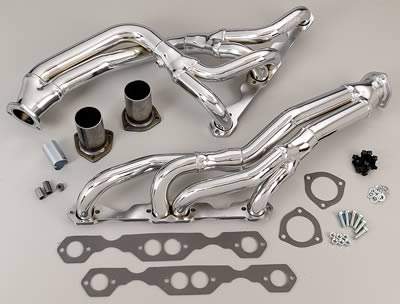

I will soon be running a set of Doug Thorley headers. Notice how the driver side rear pipe is angled inward slightly, that is engough to clear a clutch assembly. Also the passenger side is slightly shortened so it shouldn't matter about the spring clearance. The part number at Summit is DTE-364Y
Another alternative is to run block hugger headers. :dunno:
