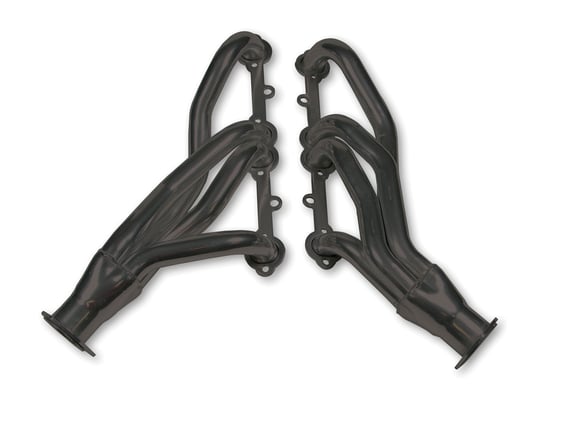

Flowtech makes some mid-length headers for Chevy square bodies. Mid-length headers fit pretty good on 4-wheel drive trucks. Those headers are cheap though, and they will give you some problems, if you do not take the time to head off at the pass all the known problems that cheap headers will give you. I have also seen that those Flowtech headers need to have the triangle 3-bolt flanges cut off of them, and replaced with a band clamps, in order to have them fit and seal correctly.
Flowtech makes some mid-length headers for Chevy square bodies. Those headers are cheap though, and they will give you some problems, if you do not take the time to head off at the pass all the known problems that cheap headers will give you. I have also seen that those headers need to have the triangle 3-bolt flanges cut off of them, and replaced with a band clamps, in order to have them fit and seal correctly.
