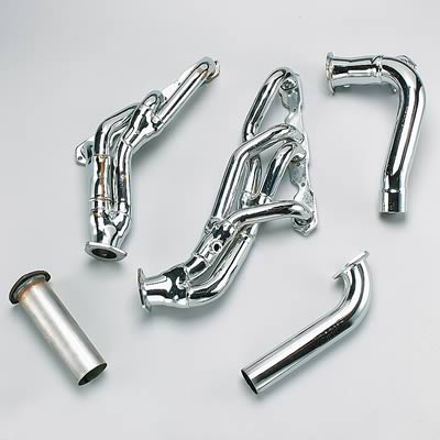

    Okay, would these fit the 90 ??? [​IMG]
  19. Thunder
    Thunder 3/4 ton status
    Joined:
    Jul 20, 2000
    Posts:
    8,946
    Likes Received:
    1
    Location:
    Northeast Nevada
    They will probabally bolt on the engine and fit ok in the frame. But you will have to build an exhaust system for them. Most all long tube headers for 73-91 blazers will fit fine. But require dual exhaust or other exhaust work.
    Thorley does make headers to fit 87-92 K5s. Including systems with X over pipes for lifts up to 6". But they cost more than Edelbrock systems.

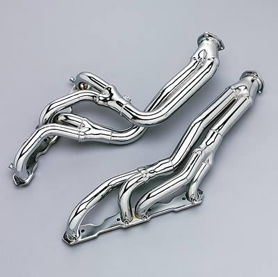

    Thorley Header Applications
    [​IMG]
    Like the Edelbrocks These are a direct bolt in also and should hook up th the stock 3" exhaust at the Cat. But I think they cost more because they are coated or chromed.
    If you have deep pockets a set of these will bolt right on also.
