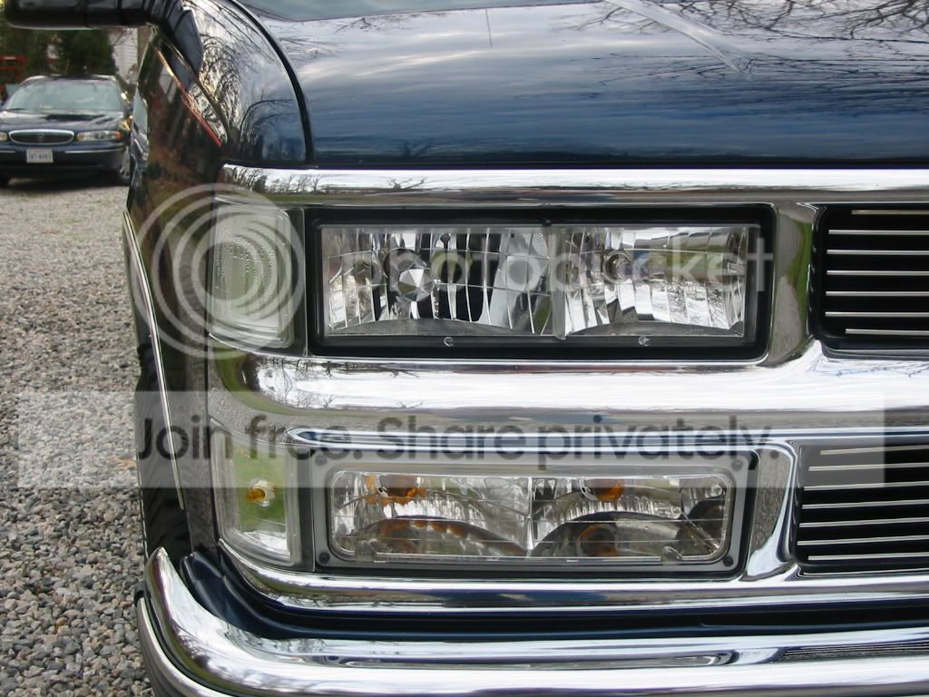

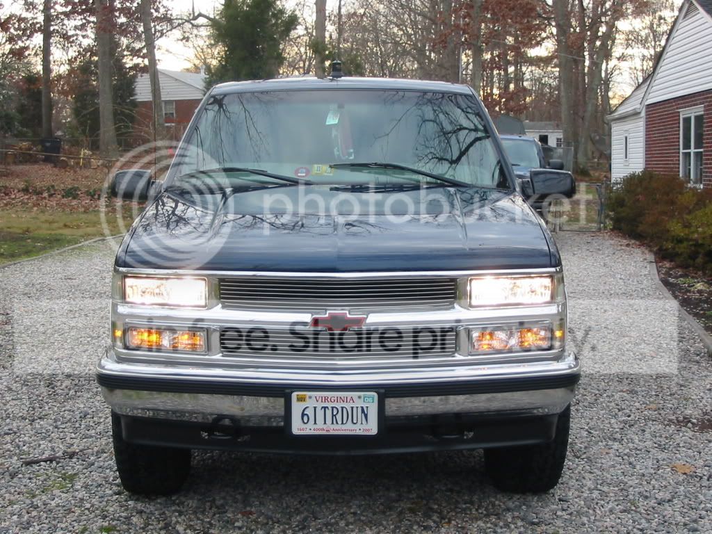

3) I put some diamond clear housings in mainly for looks but they actually increased output a little.
I believe the Kennedy Harness is ~ $130, like I said you could wire it up yourself but his is nicely done and frankly I wanted plug and play. The bulbs retail for around the same price as Silverstars, CarQuest has those. Housings are around $120.
Granted I got most of this for Christmas, I wouldve paid for it all myself if I hadnt gotten them. I can see so much better now its unreal. They might even be too bright, people are always flashing me thinking I have my highs on when really its just the lows. And lemme tell you when I crank down on those highs and all 4 lamps come on you better not be lookin at that truck cause you'll be blinded..
Yeah thats them, heres some better pics....
I have the same headlights as Chris, and I also have the TYC parking lamps also. I like them more now that I have adjusted them better. I have Silverstars that I installed at the same time, and one burned out WAY too soon, but had replaced under "warranty" (thanks again Chris!). I had my buddy that installs 3M paint protection film send me a headlight kit to add some protection from rocks (after the picture, but it really is clear):
