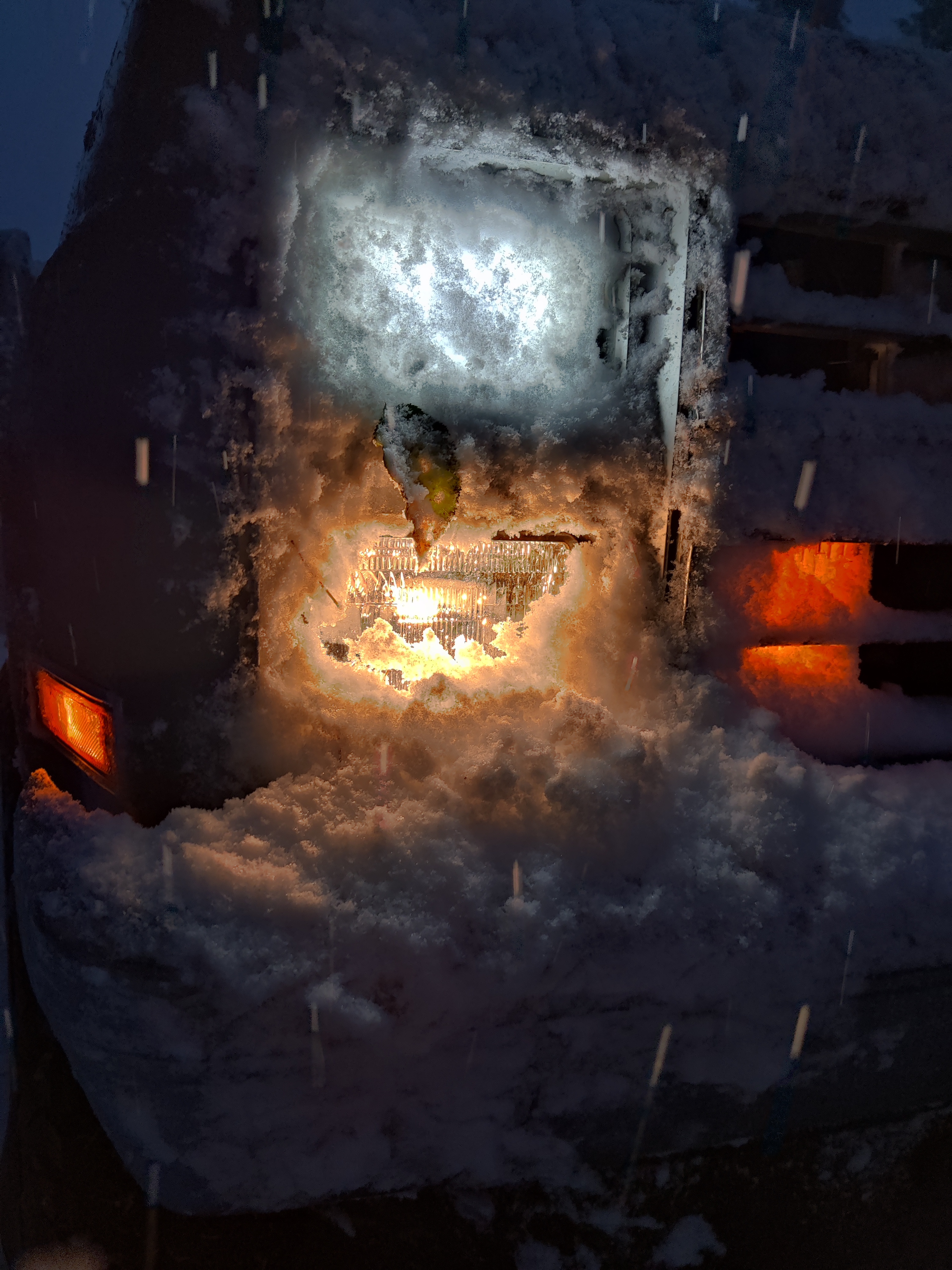

LED's can also be terrible in snow if that's a consideration.
full
I converted mine to run all four lights in low and high after that day, with the bottom pair remaining halogens to make sure I've got some light if it happens again.

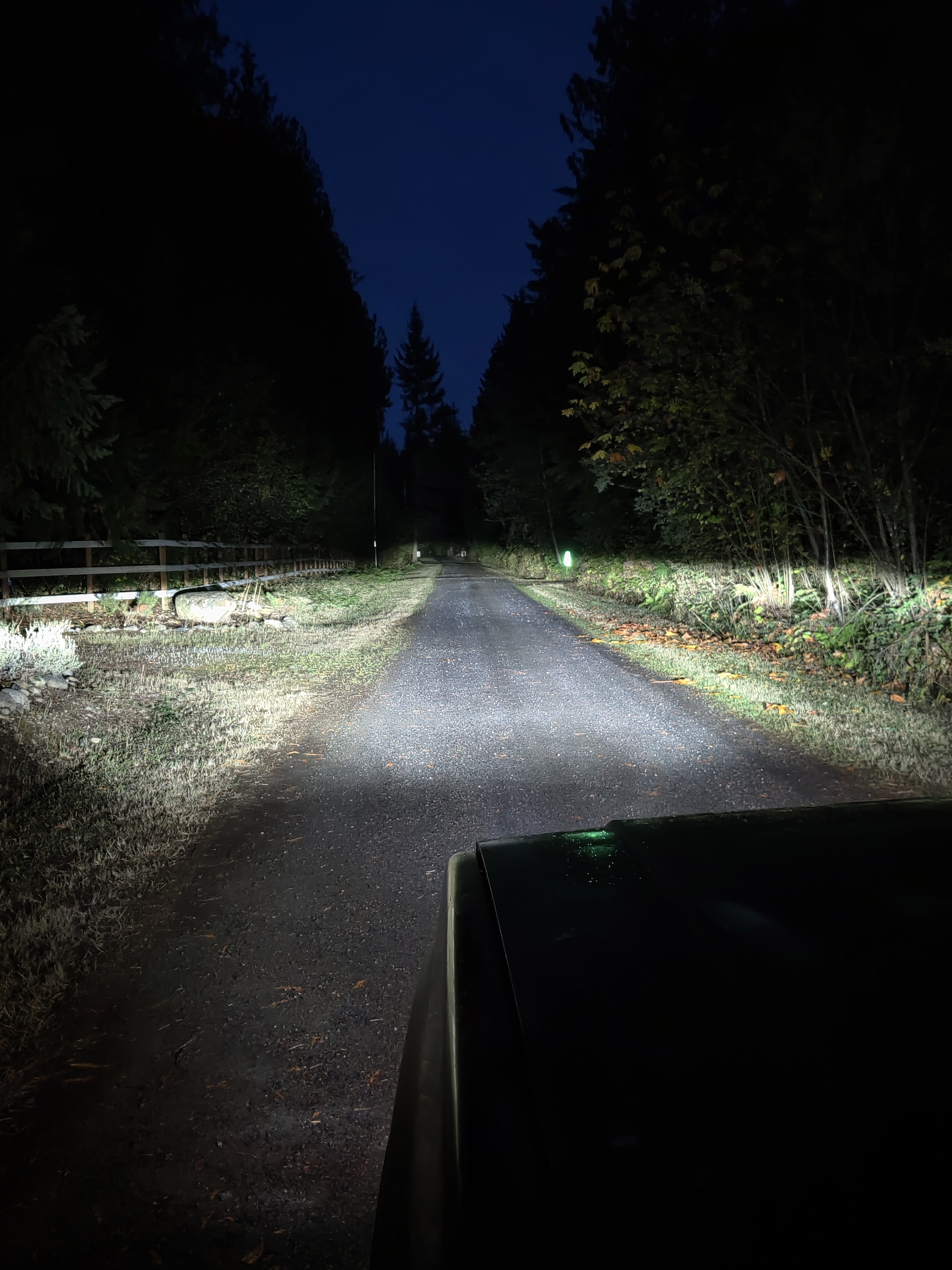

I’d say the leds were brighter on my old S10 that I had swapped in blazer composite housings. I had been running incandescent bulbs, changed to led and did the painless universal relay harness last. The leds did get brighter but I had no way to quantify how much brighter they got. It was probably not as noticeable as the difference in brightness on incandescent bulbs before and after adding relays but it was brighter with leds.
