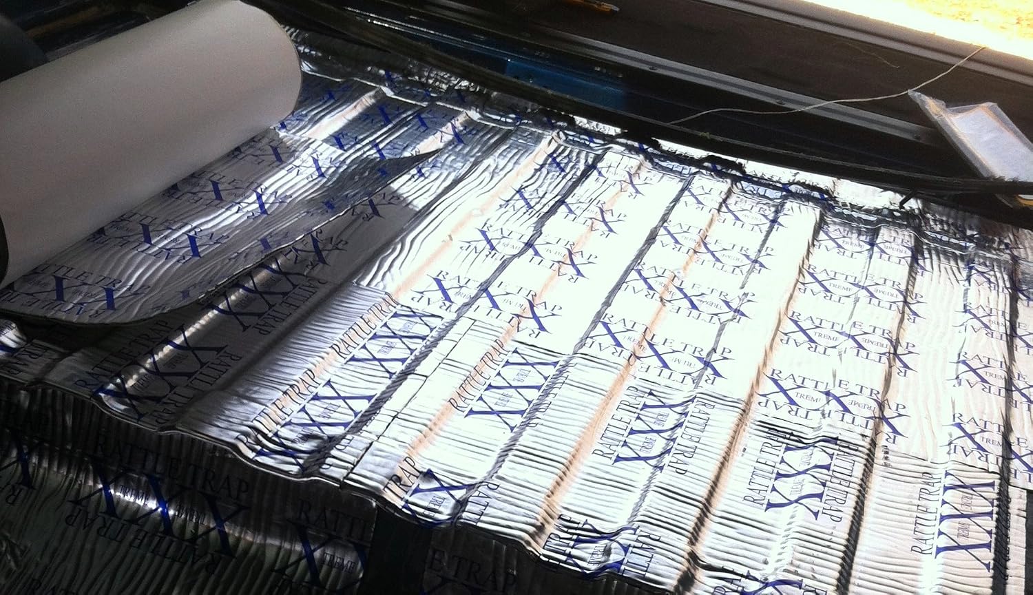

I have a Suburban with 6.2 and I've had good luck with a coat of Herculiner on the floor, covered with FatMat Rattle trap, a foil backed butyl rubber sound/heat deadner, then pad and rubber floor mat. I also stuck the FatMat on the engine side of the firewall and underside of the hood. will do the inside of the roof someday.
