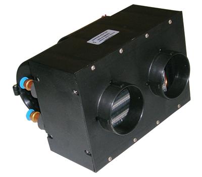

I prefer the heater from Danhard. This thing will roast you out. The fan is very powerful.
The Danhard looks nice. Guess that would save me the cost of an a/c delete kit and heater parts. Could just weld a sheet metal patch to close up the hole in the firewall, then drill (2) 1" holes or so for the heater hoses.
Sounds like a plan
Go check out my build thread for more pics on the install. I also posted some pics and details on someone elses thread for heaters.
I bought mine through JCWhitney. ( I know, I know). But they had the best price and they are always sending me the 15 or 20% off coupons also.
I purchased the 1412 Model and the Heater control kit.
The heater lists for $183 and -20% was $146. The heater control kit was a little over priced, I thought any way. It listed for $120 and I paid $96. I only used some of the parts in the control kit. You could try to scrounge up the parts yourself. A 4 position rotary switch, Y connectors (Not used, with a standalone heater) clamps and the most important was the shutoff/flow valve and cable. I opted for convenience and paid a little more.
