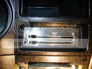

I am parting out my 75 Blazer. PM me. Here's a pic of the unit I have that you need (non-AC):
Lemme know if you need the cables and such too when you PM me.
