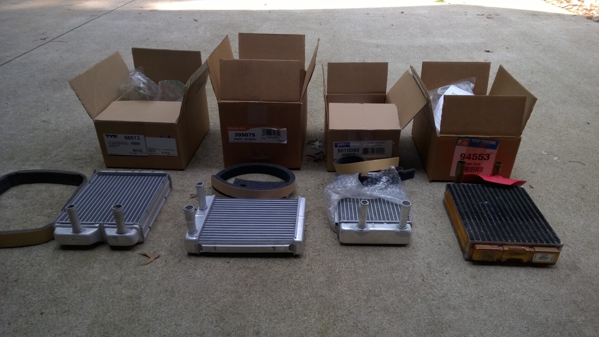

So I ordered every brand I could to compare. These are non-A/C versions
The brand I just blew up was the Ready-Aire one. Out of these, I like the copper one..Federated/Four Seasons, but it was a closeout price, so, I think they are not making these anymore.
Here's the 4 different ones I could find (click on pics for extremely large versions)

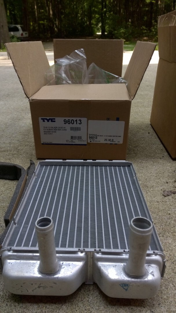

TYC P/N 96013
Country of Origin: China
Cost: $27.29
Rows: 19
Material: Aluminum
Notes:
My Opinion: Seems ok, has proper width top/bottom so it should fit in housing ok. For some reason I like the oval'd tubes where they meet the side tank

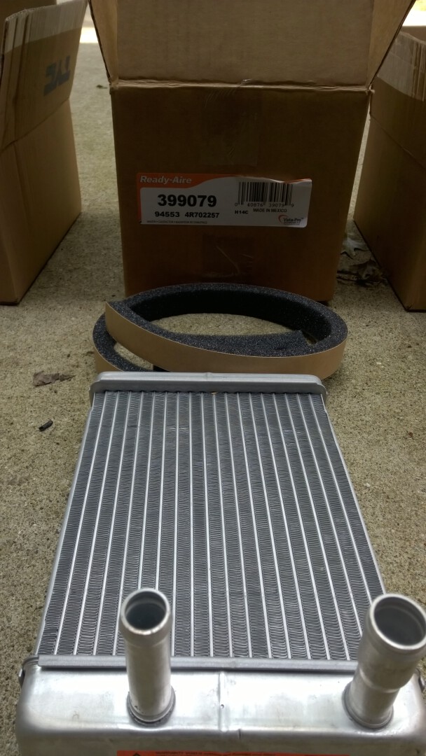

Ready Aire/Vista-Pro 399079
Country of Origin: Mexico
Cost: $19.17
Rows: 18
Material: Aluminum
Notes: Anti-Erosion Bridge -Patented technology protects heater tubes and extends the life of heater ; Elastomeric Restrictor - Placed in outbound tube of heater to optimize coolant velocity and heat transfer
My Opinion: Being that one of these just started leaking at 8000mi, I'm not impressed. Manufacturing seems sketchy, the whole thing is cocked a little, like it wasn't straight when they pressed the sides on. I had to slightly bend the holddown bracket to get this to fit in the housing proper. Top bottom plate is not full width so I had to pack some high-temp rubber in there to keep it from slopping.

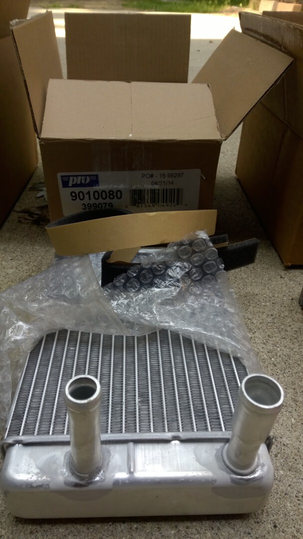

Pro 9010080 / 399079
Cost: $26.79
Rows: 17
Material: Aluminum
My Opinion: Looks ok. Top/Bottom plates aren't proper width, will slop in the heater housing without some mods. There are bushings welded into the housing and the tubes are welded into the bushings, I like that.

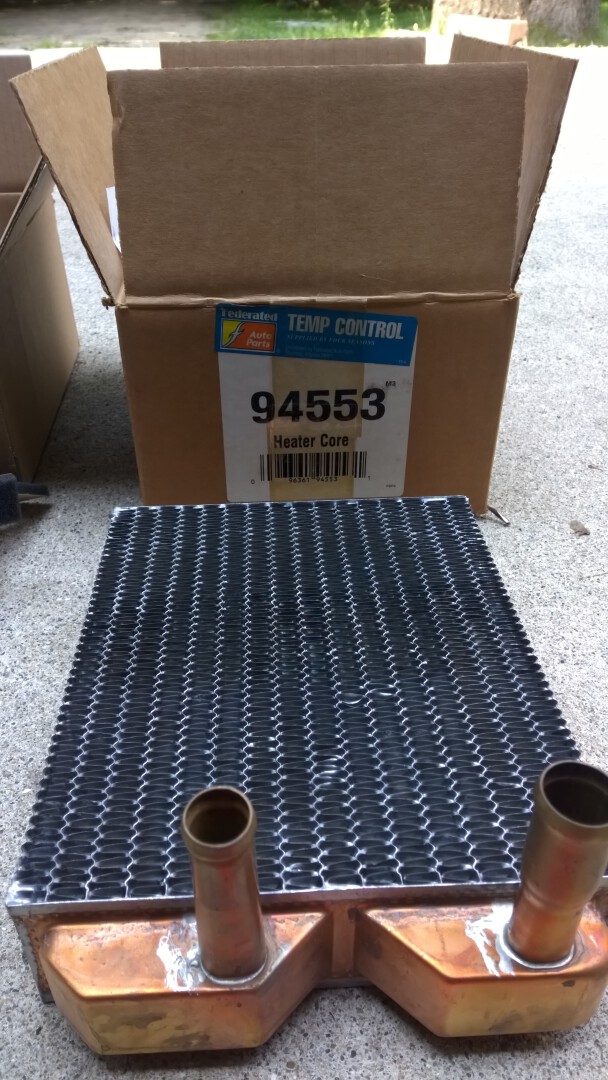

Four Seasons/Federated 7194553
Country of Origin: USA
Cost: $14.79 (Rockauto closeout price) Regular Price: $44.65
Rows: 17
Material: Copper/Brass
Notes: OEM size/fit. I think their plain 94553 (without 71 in front) is alum. but it doesn't say.
My Opinion: I like that it will fit without modification of the holddown bracket and won't slop in the housing. I like that it's copper. Can be fixed. I think I'll try this one!

The ready-aire/vista pro one that was in there was cracked where a tube meets the side can. The alum. side can is sooooo thin. And one detriment to alum, especially thin alum, it doesn't bend as easily, alot more brittle, it just tears.

I put the Four Seasons / Federated copper/brass version in there. I tell you what, it's hard to tell because it not really winter, but I've always thought the heater was a bit weak...the heat was pouring out, nice hot air with this copper/brass version. It may be because it's just alot more surface area, alot thicker than the alum. ones. We'll see come winter time...
If the copper brass version isn't available anymore, I think I'd try the Pro one. It had nice bushings to spread the load and I couldn't move the tubes with some decent pressure, where the TYC and vista-pro versions I could wiggle the tubes some (bending the side can as you moved it), TYC not so much, vista-pro..tubes would move very easily, I think I just got unlucky at the parts store last time and made the wrong choice.
