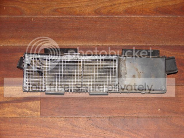

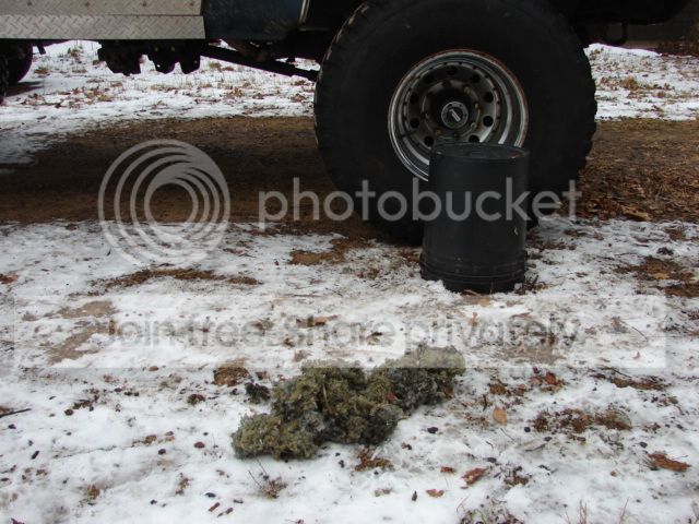

There was a mouse nest in mine. I installed a screen guard to keep them out.
Boy, if there are mice in your interior, there are a lot of problems they can cause besides just blocking the ducts.
