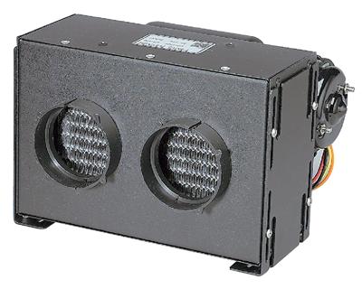

I took one of these out of a semi truck cabover sleeper berth. Might be a cheap alt for ya. This one only had one fan in it but the truck had one of those fans in the driving area. The motor and blades fit perfect to put the second fan in it. I may put for a rear heat deal in the blazer. Originally a idea for the truggy
