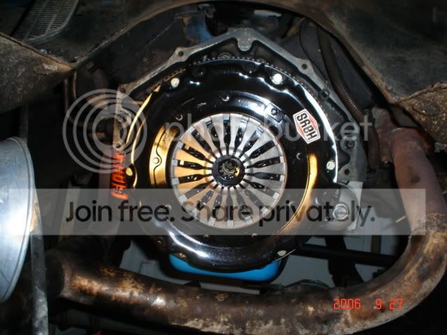

I pulled this out of my Suburban yesterday. The center hub has separated from the disc and slips. :(
That is a Sach's disc with maybe 10,000km on it (behind my 6.2L diesel). It looks to me like the damper springs were bottoming out to cause that damage.

i got a Hays clutch meant for pulling trucks. 12 1/4" diameter and quite burly. All I've ever heard about Centerforce was that they're basically a rebadged Luk. The disc itself is usually Luk.
Burt's automotive on King George hwy in Surrey carries Luk clutches. If I had found that out a couple of weeks earlier I would have bought a Luk pro-gold from there instead of getting the Hay's through Jeg's. Not that I'm unhappy with the Hay's...but I wanted a Luk pro-gold from the get go.

Yeah, I left the damper on the NV4500...I didn't see any reason not to and I also couldn't see an easy way to remove it. I would have needed some sort of spacer or something.
Rene
