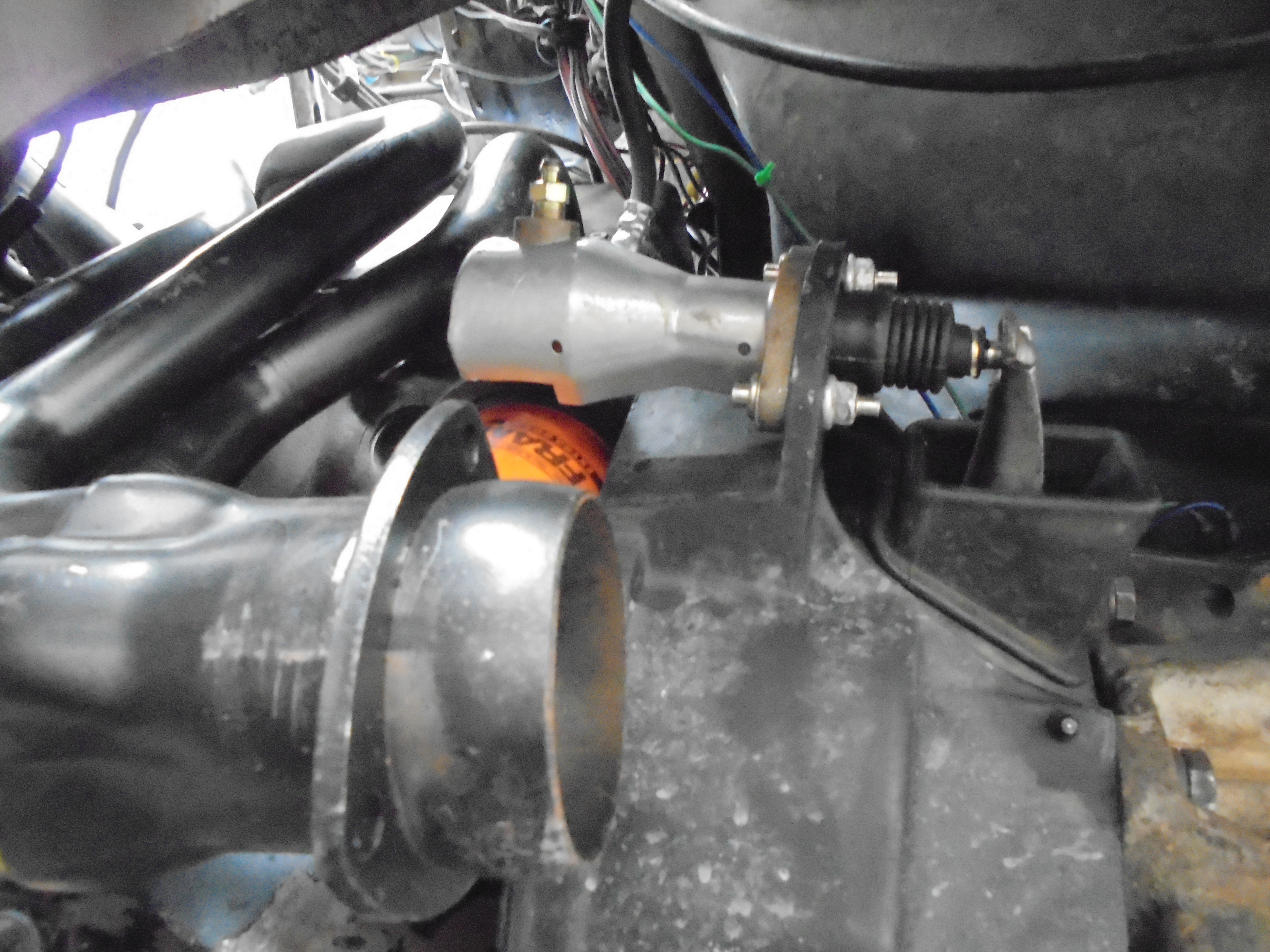

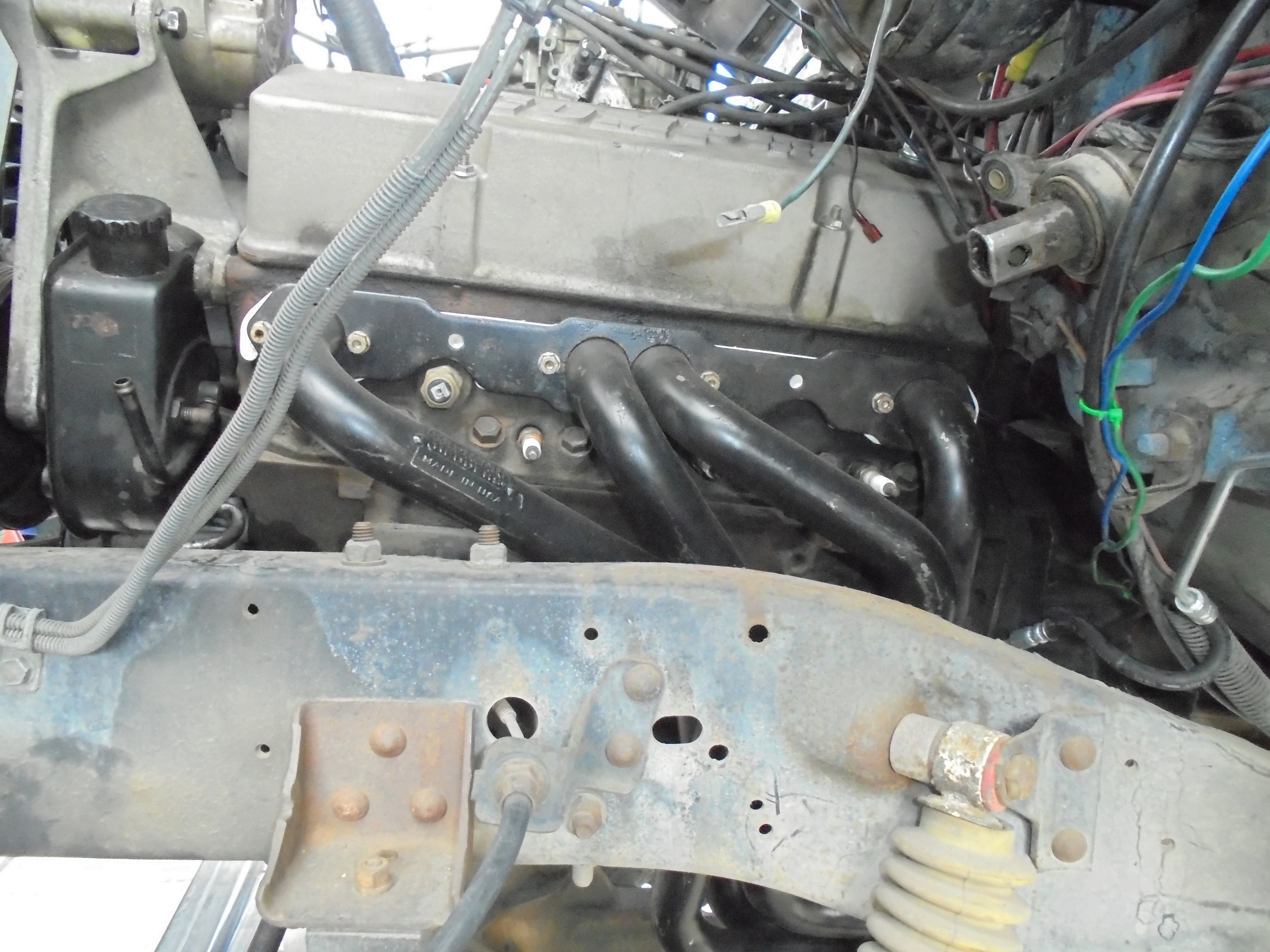

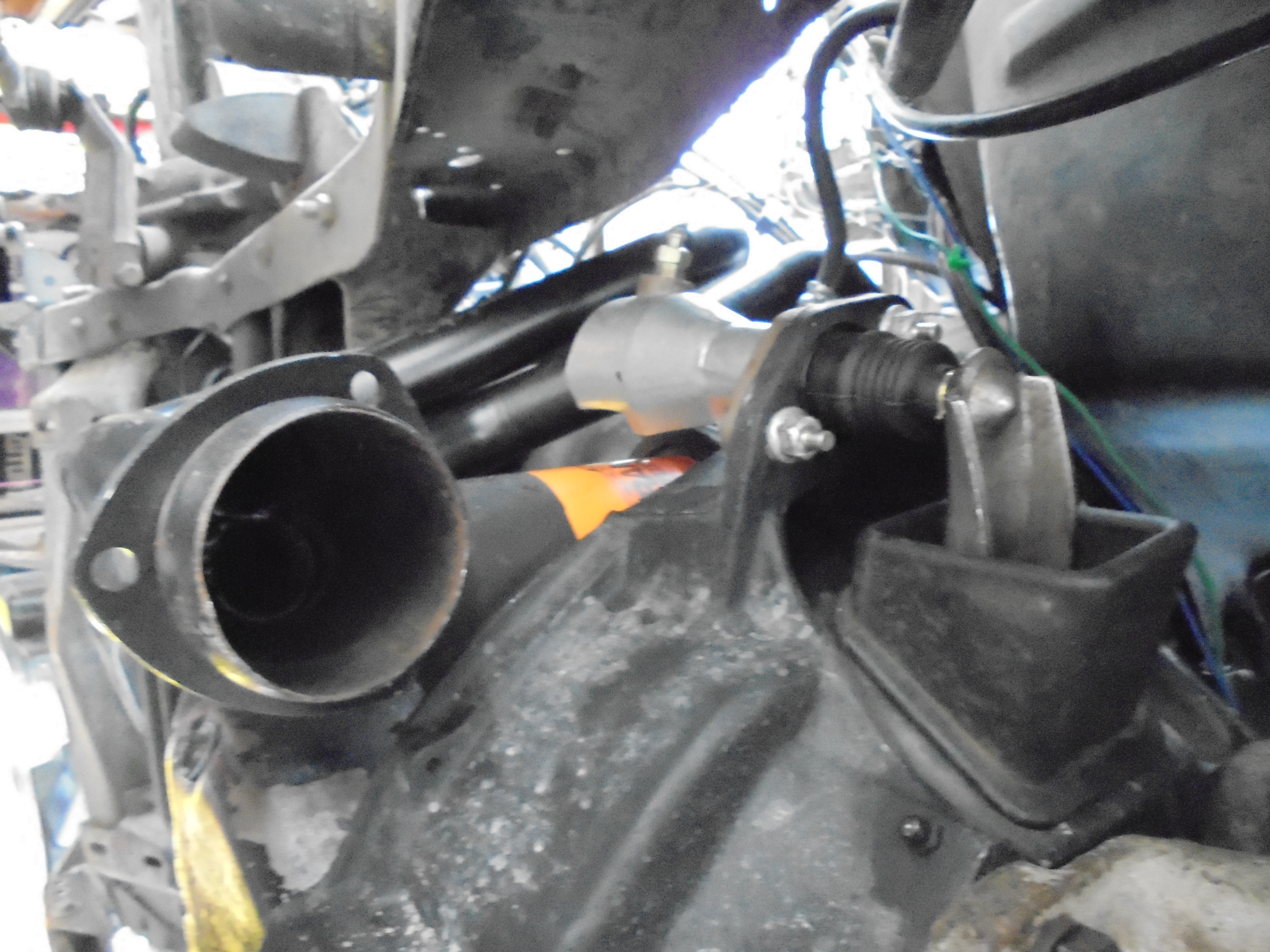

I'm finishing up my exhaust with some 68310's. (on a 84 K5)
I can get some pics up later today if you'd like. It definitely tucked them up higher than my old long tubes which is what I wanted. It clears my shackles and clutch parts pretty good. Only thing I would have preferred a little differently is the Pas side header. Its collector doesn't exit straight back. It is angled slightly towards the frame rail. No big deal since I am completely redoing everything from the collector back. It's just I had anticipated it to point straight back like the drivers side.

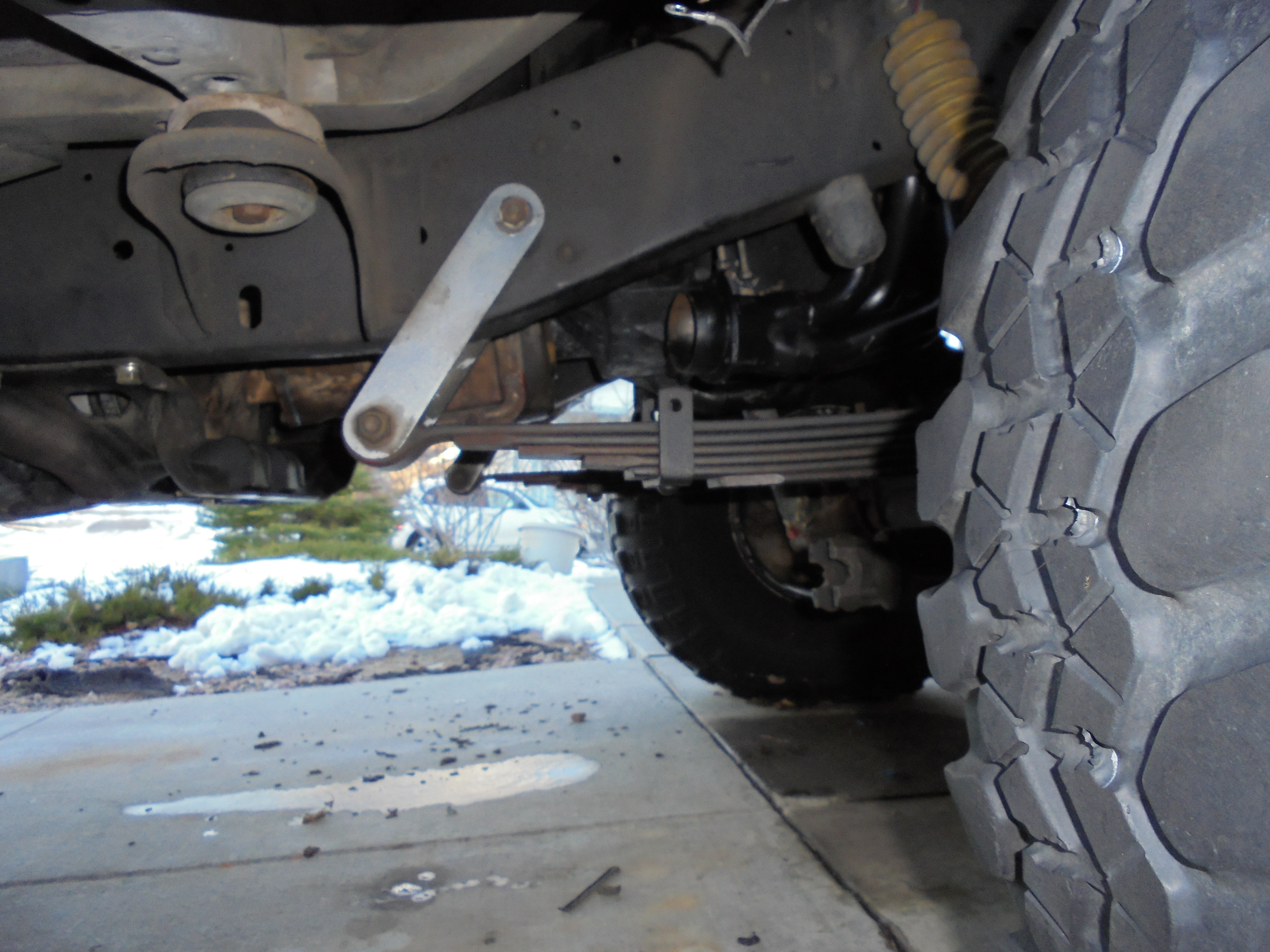

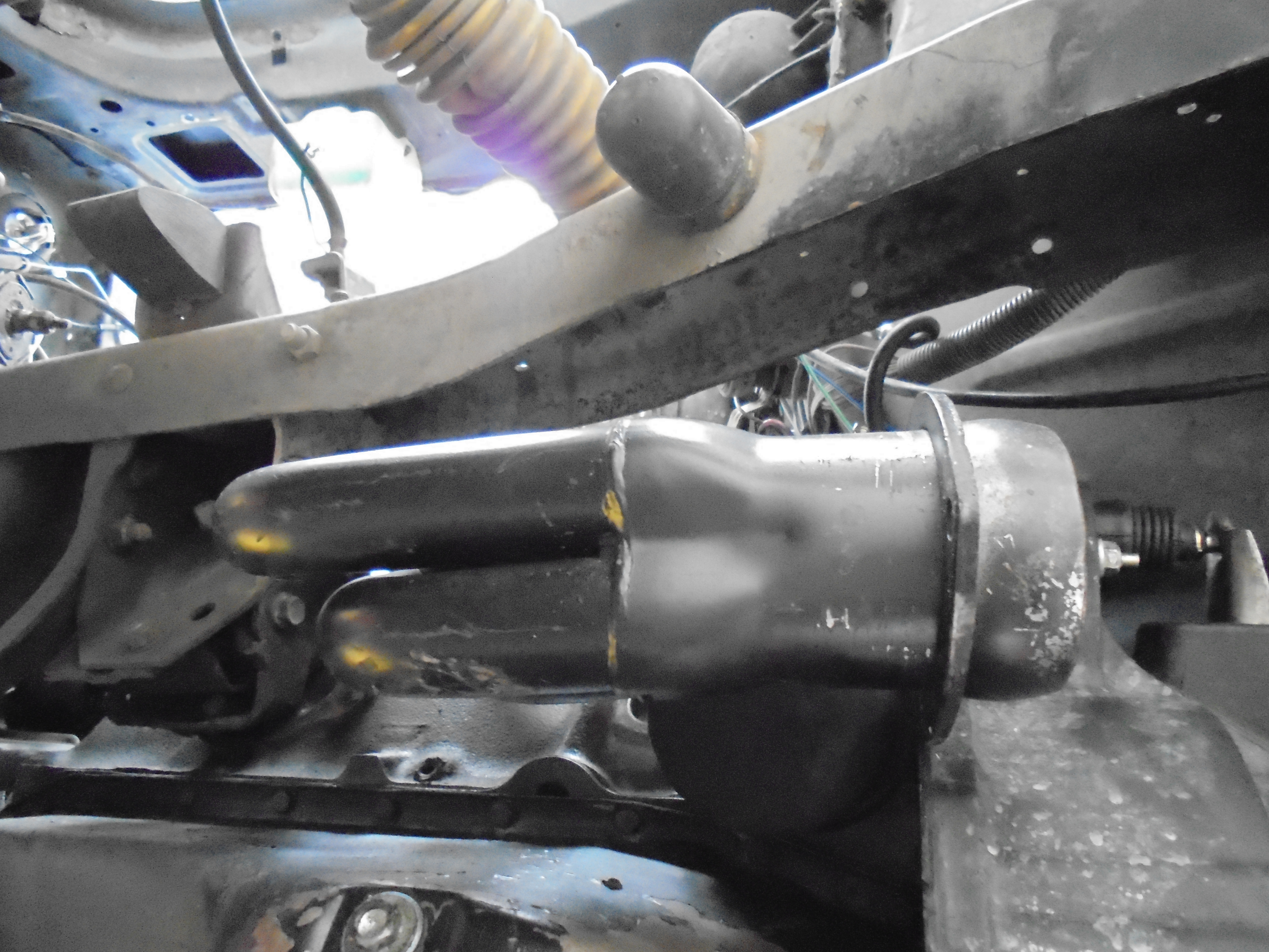

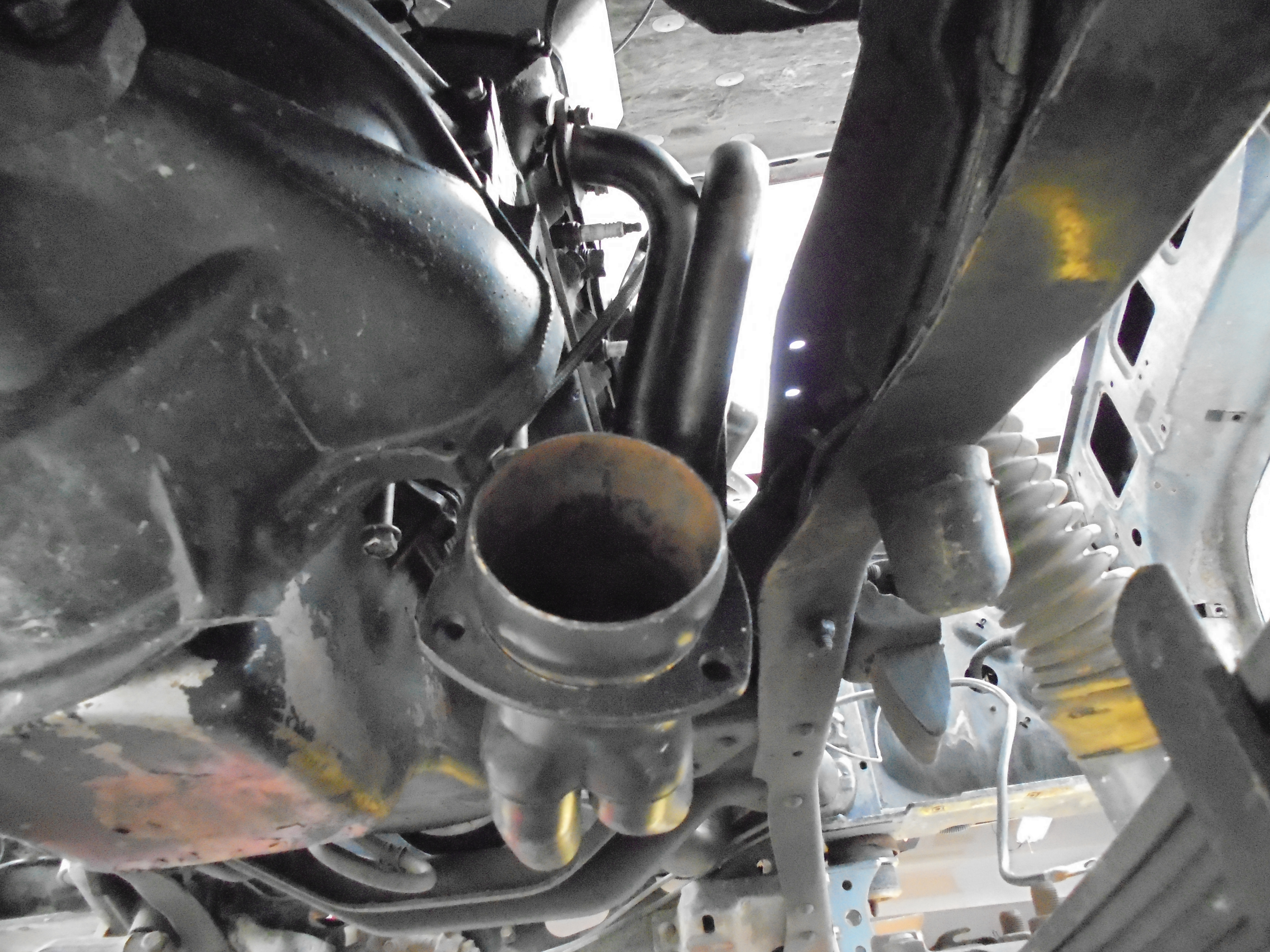

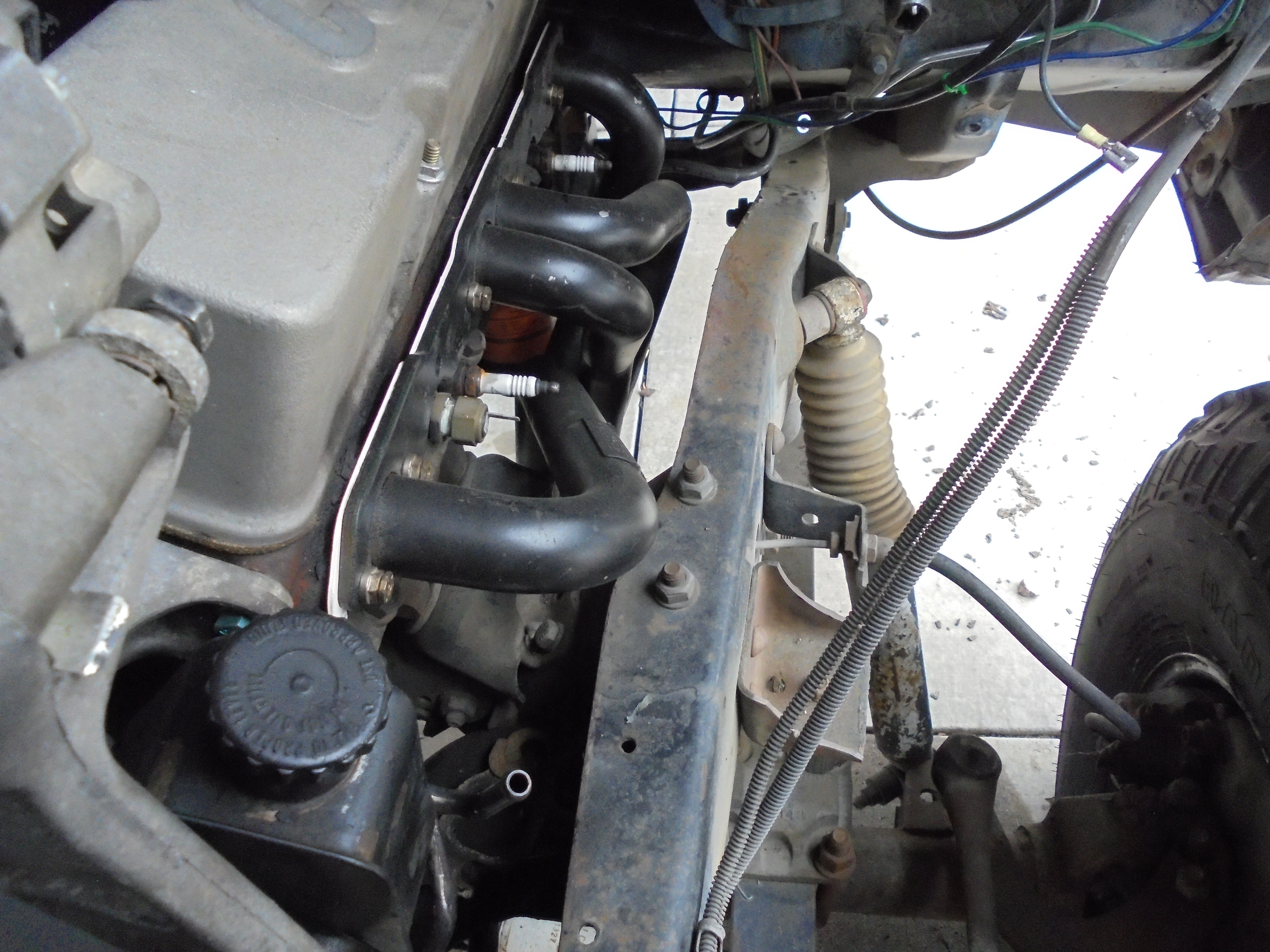

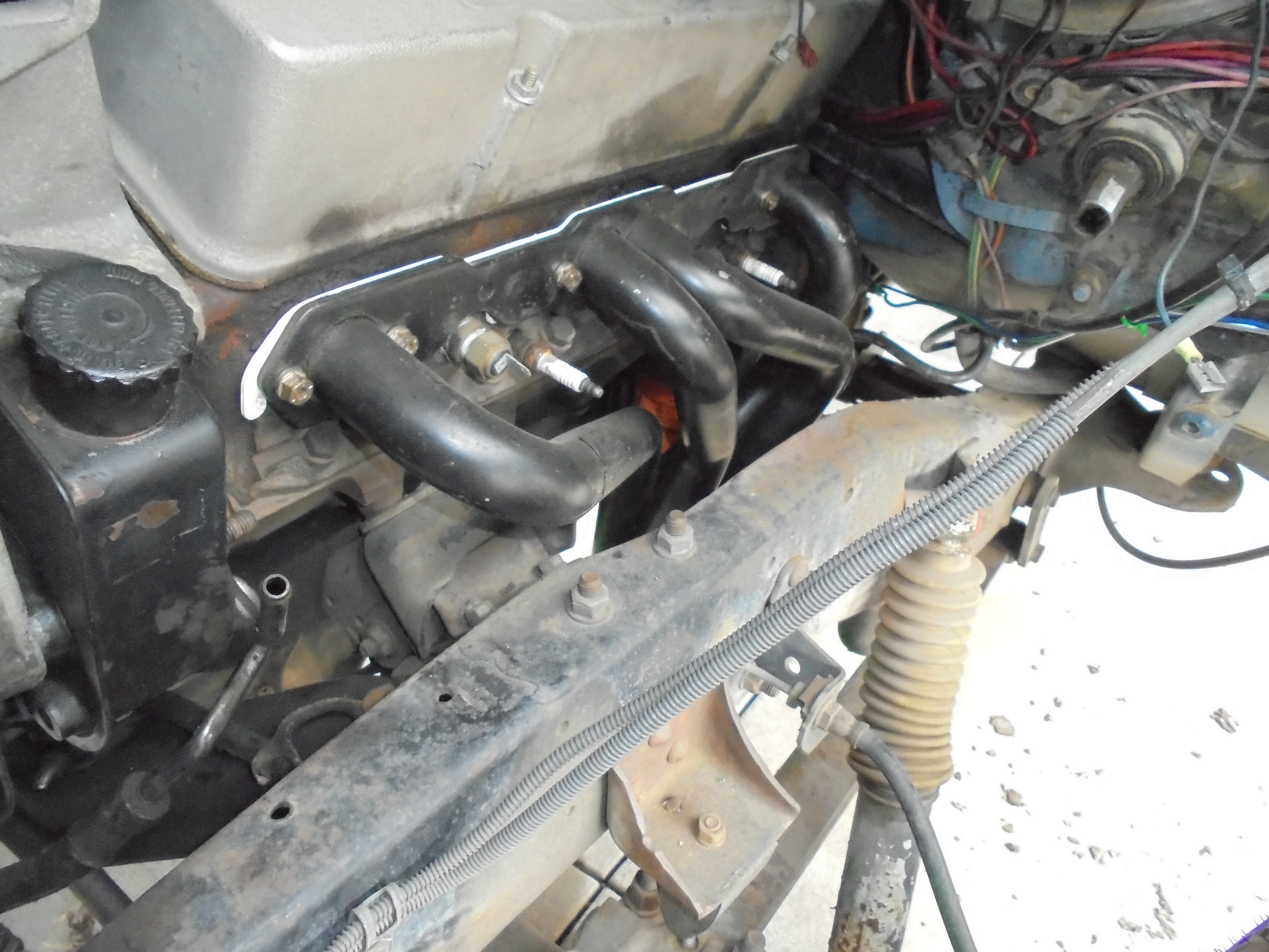

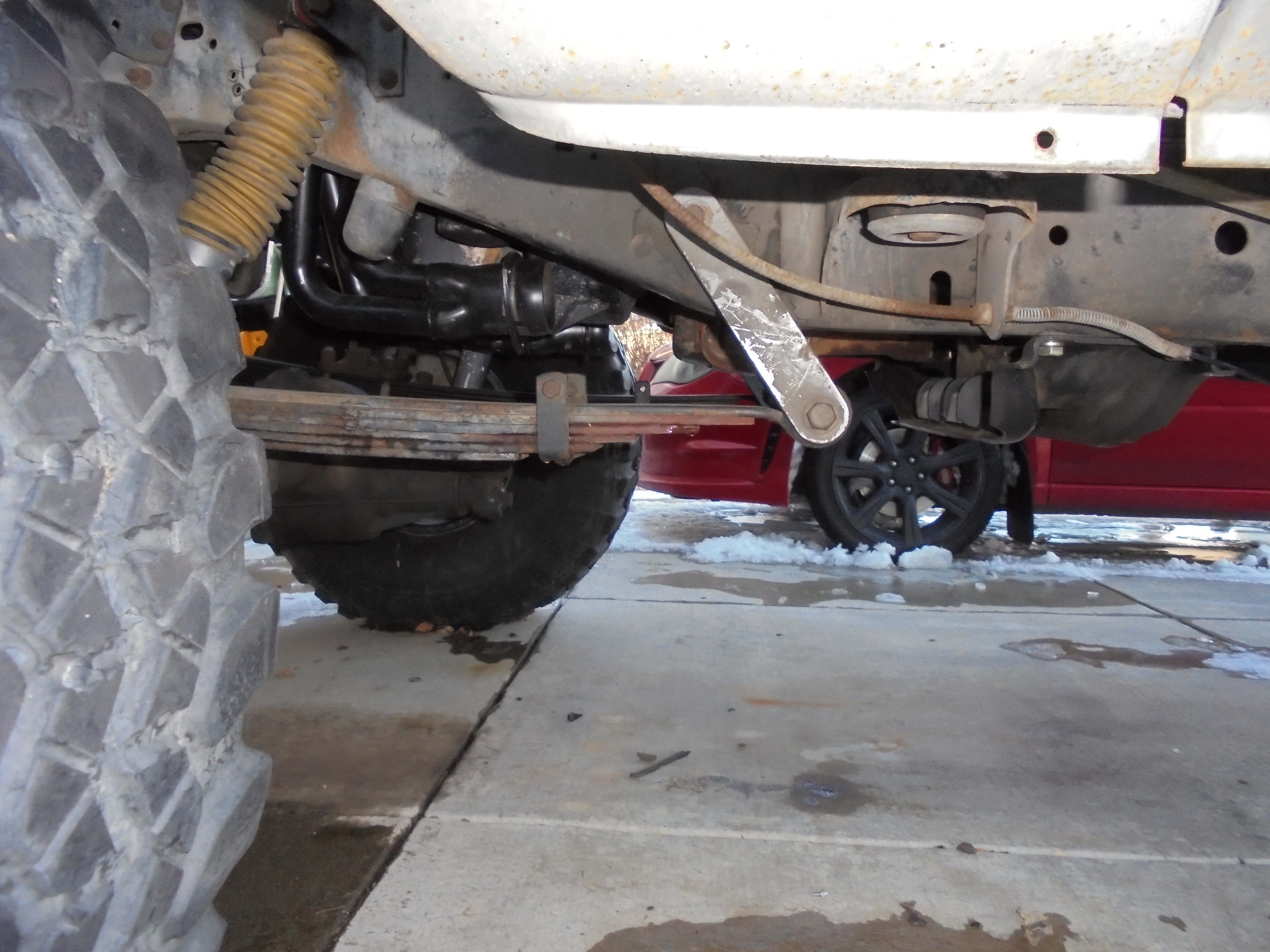

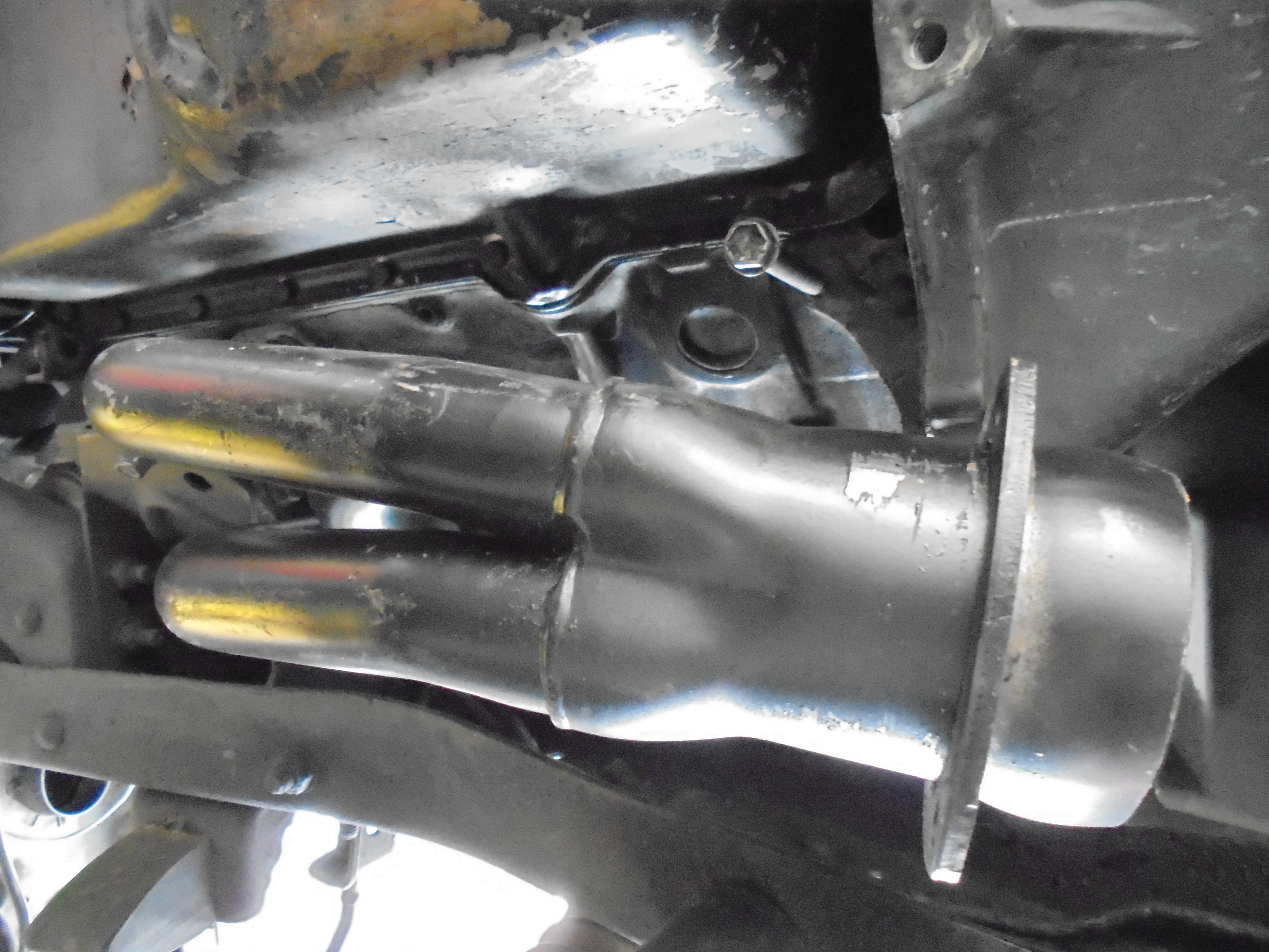

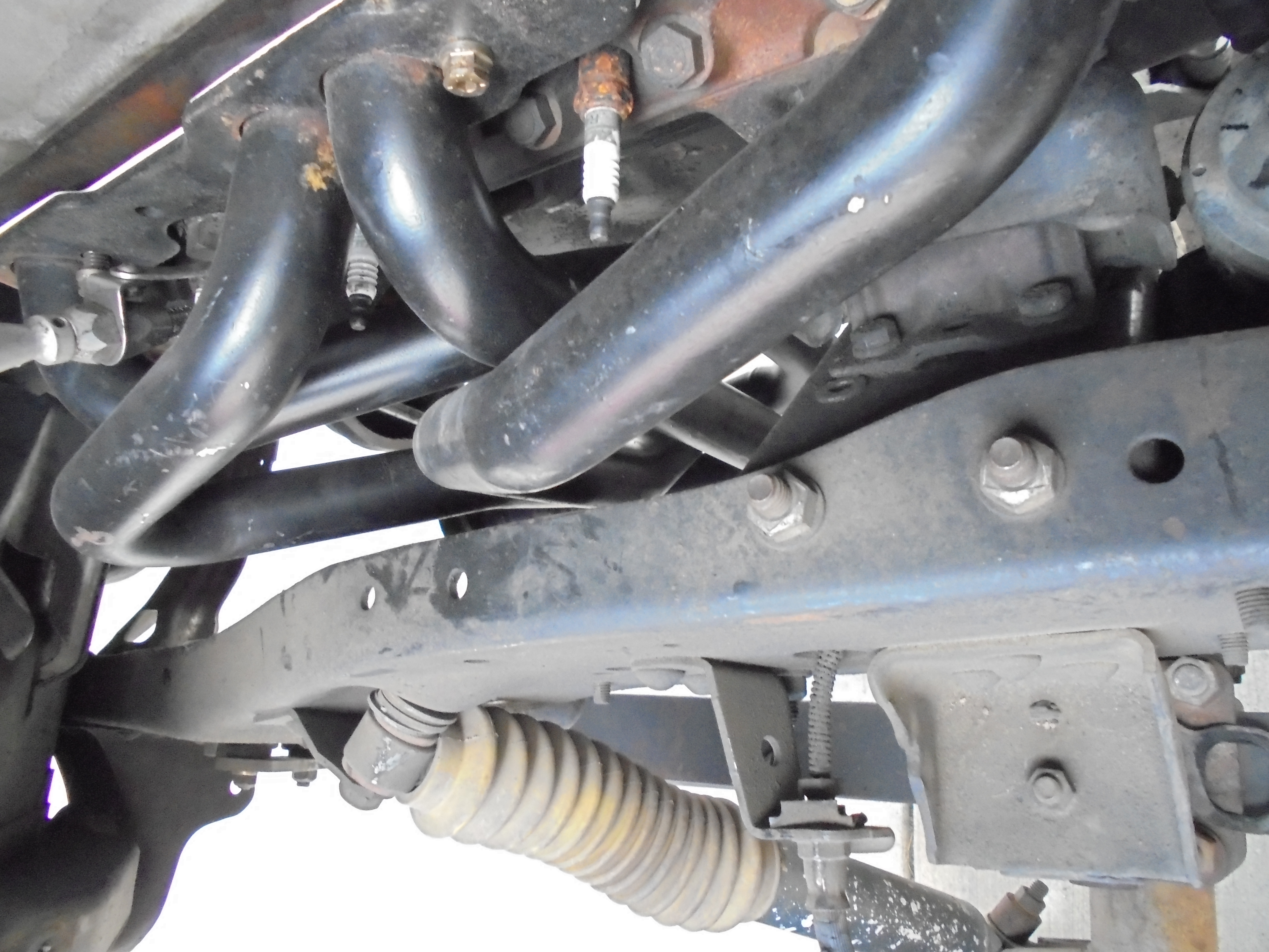

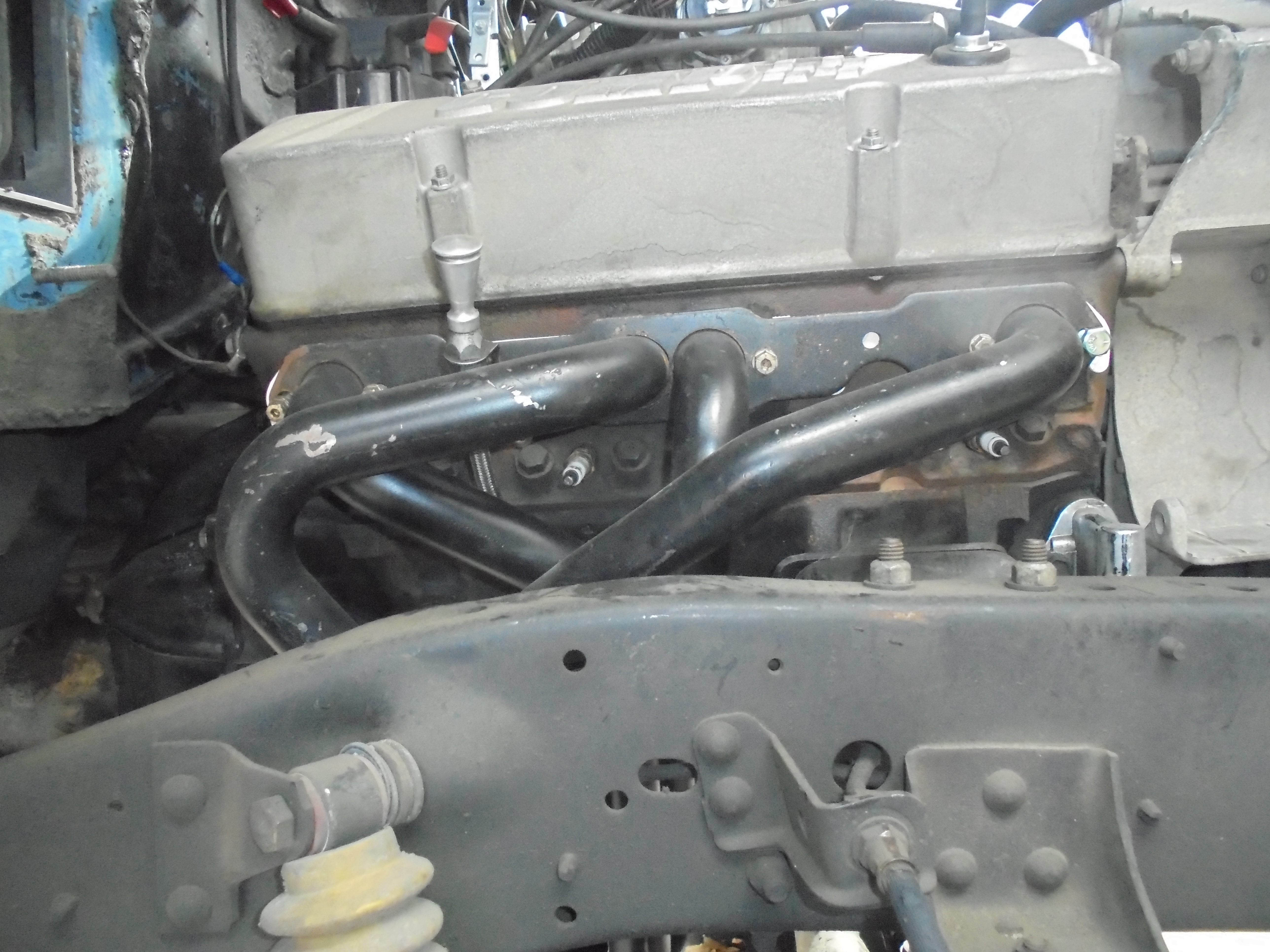

I've been meaning to get these pics up but then I realized I missed taking a few shots from the side/underneath. I was going to snap some today but its been snowy and blowing all day today. But here is what I have so far.
Pas side:
full
full
full
full
You can see how the pass side points out towards the frame a bit to help clear the starter.
For the most part I like how these headers pretty much put the rest of the exhaust right in the frame rails. I'll hopefully have the rest of the pics up as soon as I finish welding up the bends and get everything back in the truck.

Those last 2 really complete any wondering. Thanks man, I rarely get good news on my low budget :crazy: I'm looking forward to giving mine a good coat of hi temp paint and bolting up some punch n rumble :saweet:
