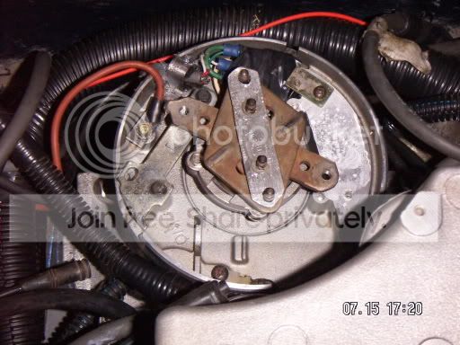

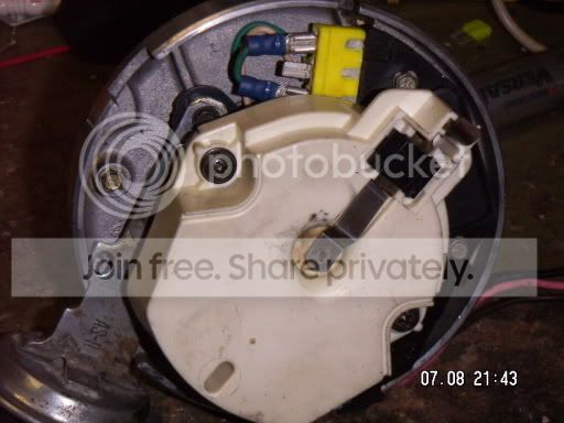

I was going to convert my ESC dizzy to non-ESC and I think it is as easy splicing the green and the black wires together. I researched it and did it as shown in the picture below, which should be the cleanest and simplest implementation. However, I ended up going straight to full electronic control and locked everything down as shown in the second picture. So they can be converted from advance to non-advance, but I never confirmed that this ESC bypass works.
