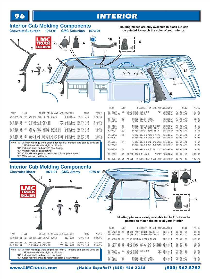

I always remove all the other trim when I take the dash pad off and put it back on.
What trim are you speaking of, I am about to swap out my dashpad for a Summit one soon.
Since my truck is a '76 I've only got the upper A-pillar trim to mess with (part 2 in the diagram below). I know the 'newer' ('81-'91) trucks also have trim on the lower part of the A-pillar that covers the footwell sides too. Parts 2 and 3 in the LMC catalog diagram below:
