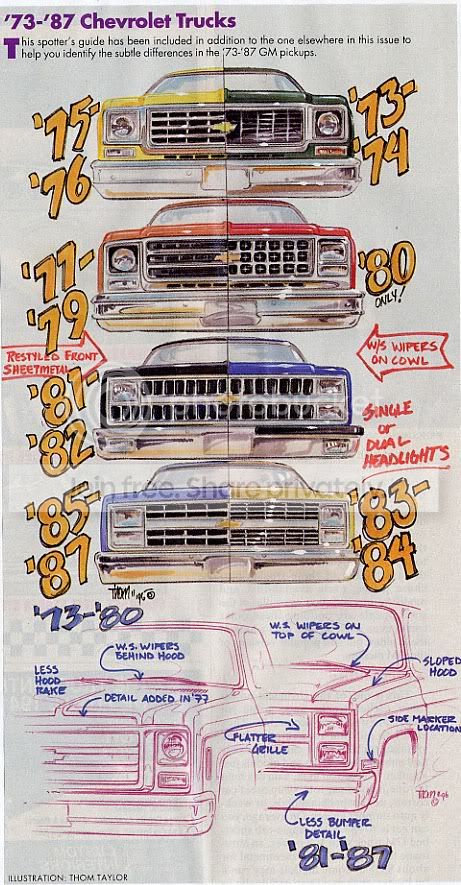

Yes 78 was the first year of the dropped floorboard, as well as moving the body mounts to the out side of the frame. Also 78 was the last model with out a gas door. 77 had a 15 slot grill and the 76 had the 32 slot grill. That's about the only way to tell a 76 from a 77. If the grills were swapped then it's a numbers only game.
This has helped me a few times.
