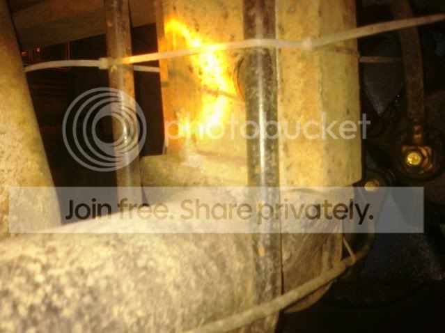

They are torqued to around 120lb and its cause the way the blocks are made that there not solid and where it meets the spring perch its only about 1/4 inch thick and the way the perch is on the 14 bolt theres only the surrounding edges. That from the torque it cracked the block right around the edges towards the front of it and its rotating the pinion up and leaving a 1/16 gap at the back of the block.
Ill get pics tomorrow.

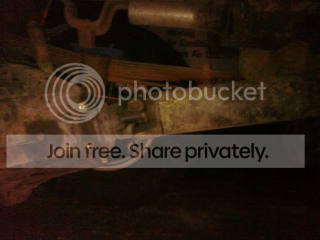

Here are some pics sorry for the dark pics i just took them.
Pinion angled up
Really looks like the center pin is already broken, anything is better than those blocks :eek1:
thats what im saying, im not gonna trust that at the badlands, the center pins are there but were loose when i swapped axles. The zip tie is holding my disk brake line not block in place haha (buddy did it)
