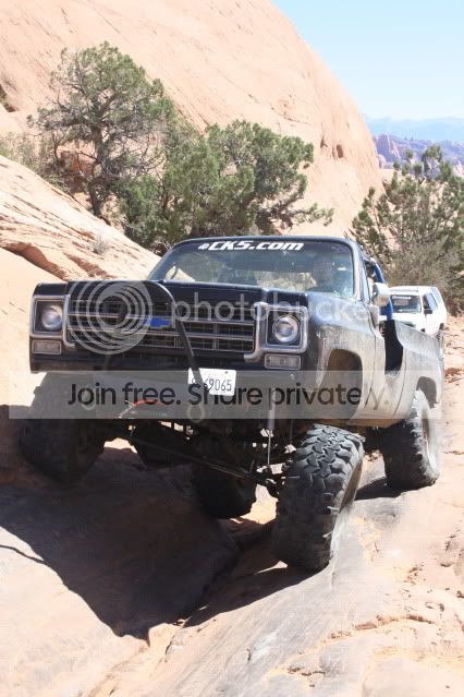

How do you have that mounted? Does it come with a higher stinger and mount for GM?
Oops forgot i had to make my own... :doah: :whistle:.i like that design, what are specifics. Of the tube etc.
Please......
I wonder if that is adaptable to a nbs style body (2005) silverado..i like it. It also lends its self to additional tube later..ill check it out ..
Both i like, maybe combine them some how without too much excess

The newer rigs have the frame rails further apart, so that style bumper will end up wider, which IMO is better as far as the bumper is concerned. DIY4x can build you pretty much whatever you want.
