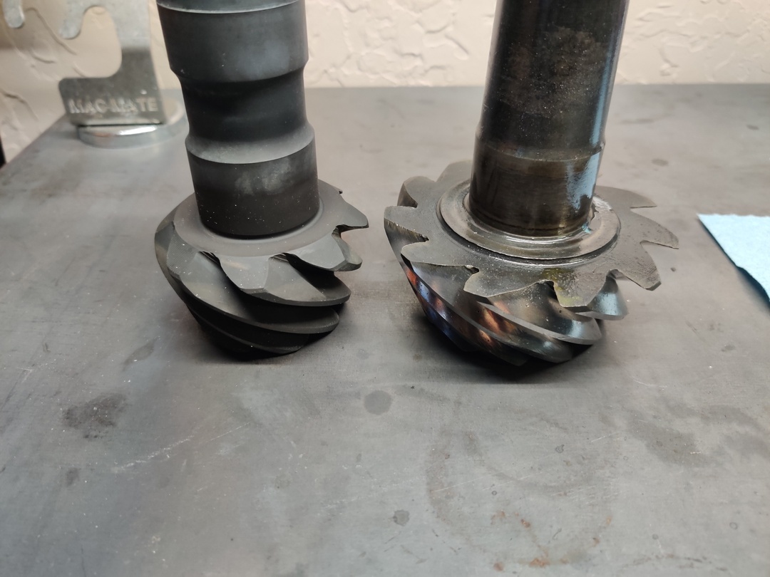

Thanks again, everyone! I ended up swapping out the 4.56s for 5.13s today. Working on getting the front setup now, and damn, that pinion does look tiny!
5.13 pinion on the left, 3.73 on the right:

That's the reason I don't like the 5.13
Pinion too small and not enough gears engage at the same time. But hopefully if the gearing is comfortable enough it will not put much of a load on it and it will not break
I never thought much about how "lower gears" have smaller pinion gears and larger ring gears...no wonder the 3:08's never seem to fail,they have more teeth in contact and more surface area..!..

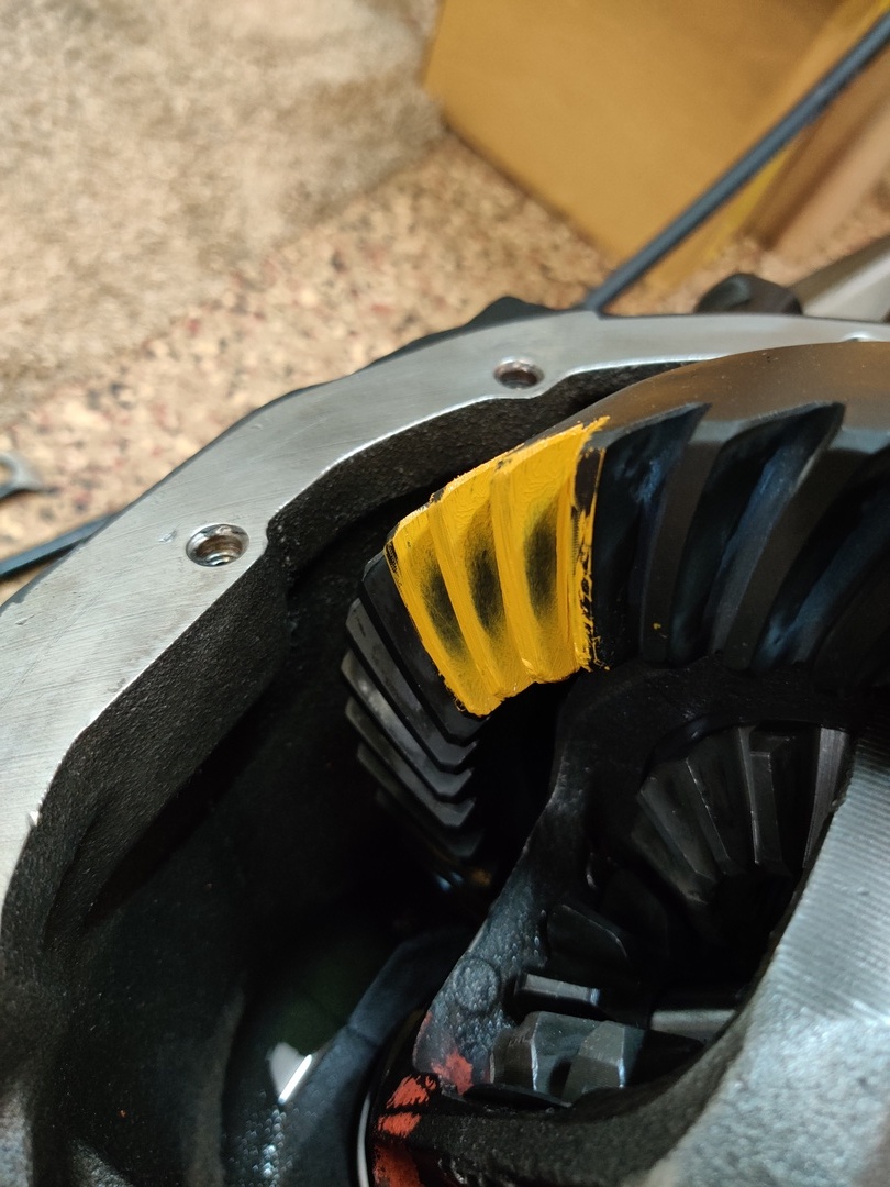

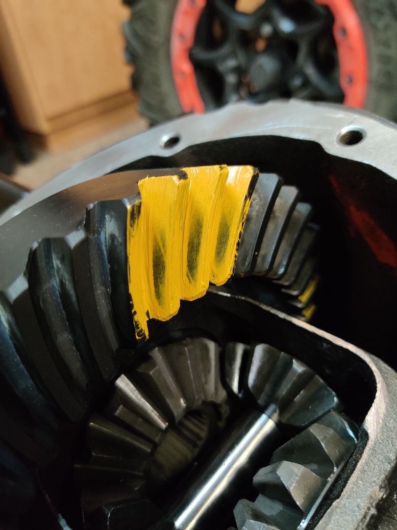

Tonight I finally got some time to start setting up the gears in the 10 bolt. For initial setup I used the old pinion shim and played with the carrier shims until I had backlash within spec (0.006-0.010"). Here's what that the contact pattern looks like so far:
Pinion Shim: 0.035"
Backlash: 0.006"
Drive:
Coast:
Am I right in thinking that the pinion may be too close to the ring gear and that I should decrease the pinion shim thickness slightly? Maybe open up the backlash a bit too? How does this look to you gear setup pros? :)
I’m no pro but it looks pretty good to me. Not too far in heal or toe and pretty well centered on the gear. Mine looked similar and ran fine. You could try moving the backlash to try and get a tad more since you are at the minimum but it will wear in and just have to watch the heat as it breaks in the first few miles. If it’s too hot you are too tight on clearance. I did that in my 14 bolt. Luckily i only went a couple miles on it and checked. Went home and opened it up .002 to get it at .008 and has been running good 10 yrs.
