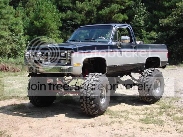

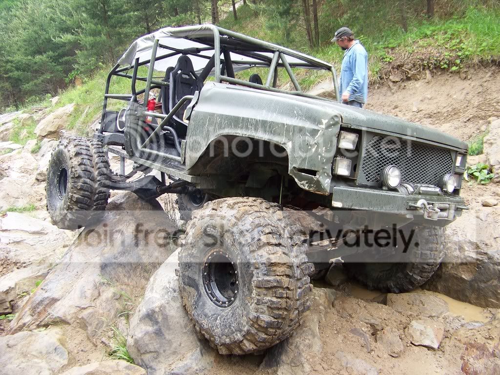

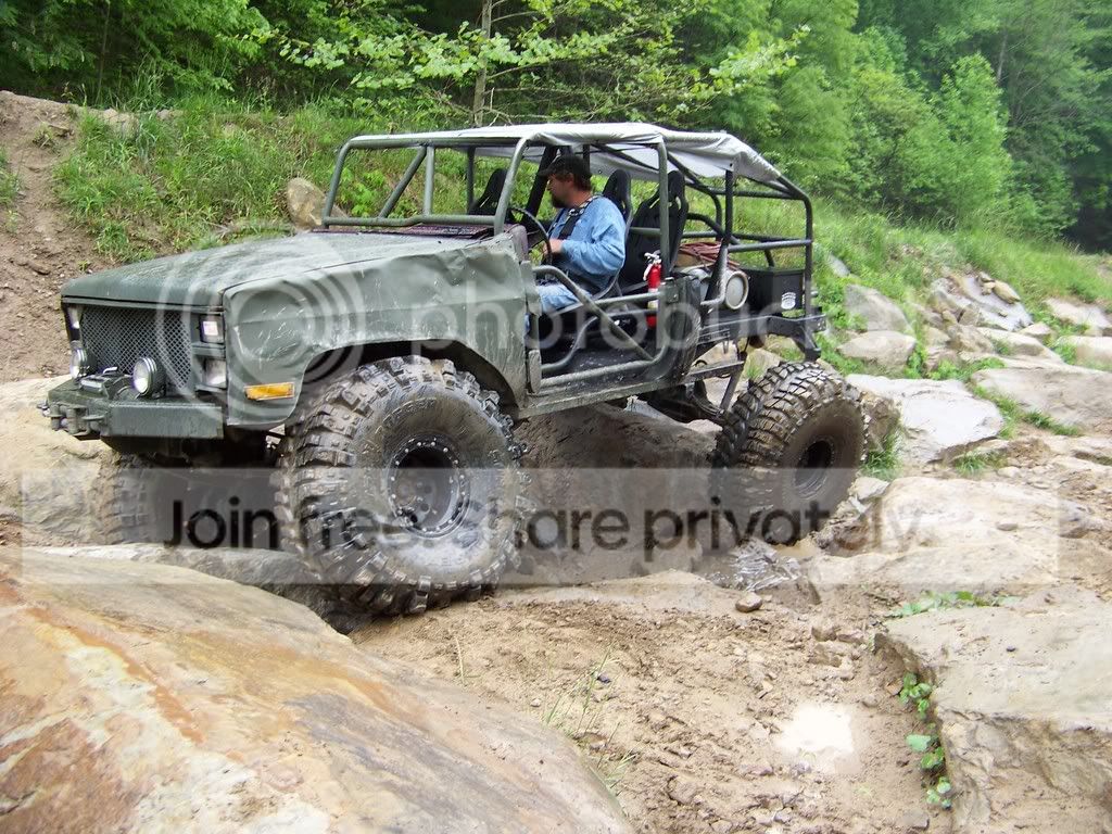

i love how big they make tires look if you take a 44 16.5 and put it next to a 44 15 it looks so much bigger pic for instance
44 16.5 (mine)
44 15s formud and copesistic (theyres ore on 15x14s where mine where 16.5 x8 and they still look bigger)
