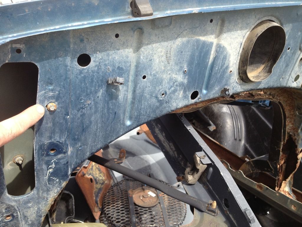

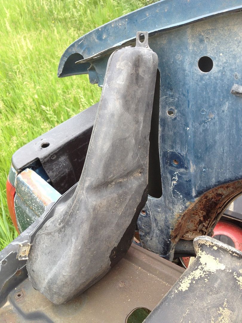

That fender was gone, but I had this one off of a 1990 K30.
This screw holds the front in place.

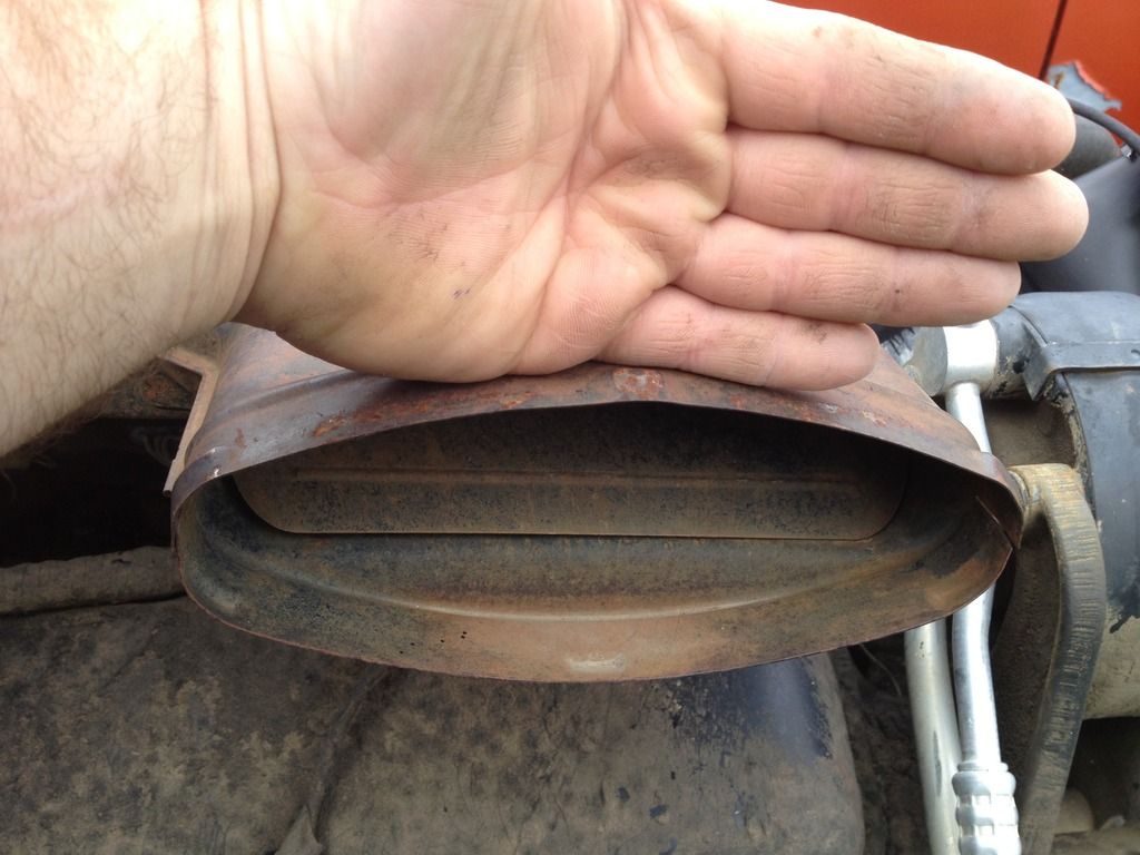

This piece connects to that duct, and points forward.

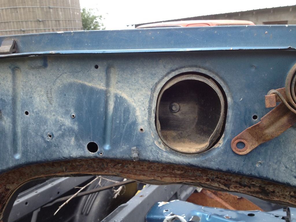

Then I realized the 454 air cleaner had a much larger air inlet.

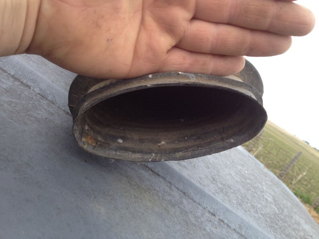

In comparison to the small block air cleaner.
So I thought the ducting wouldn't really work for you.

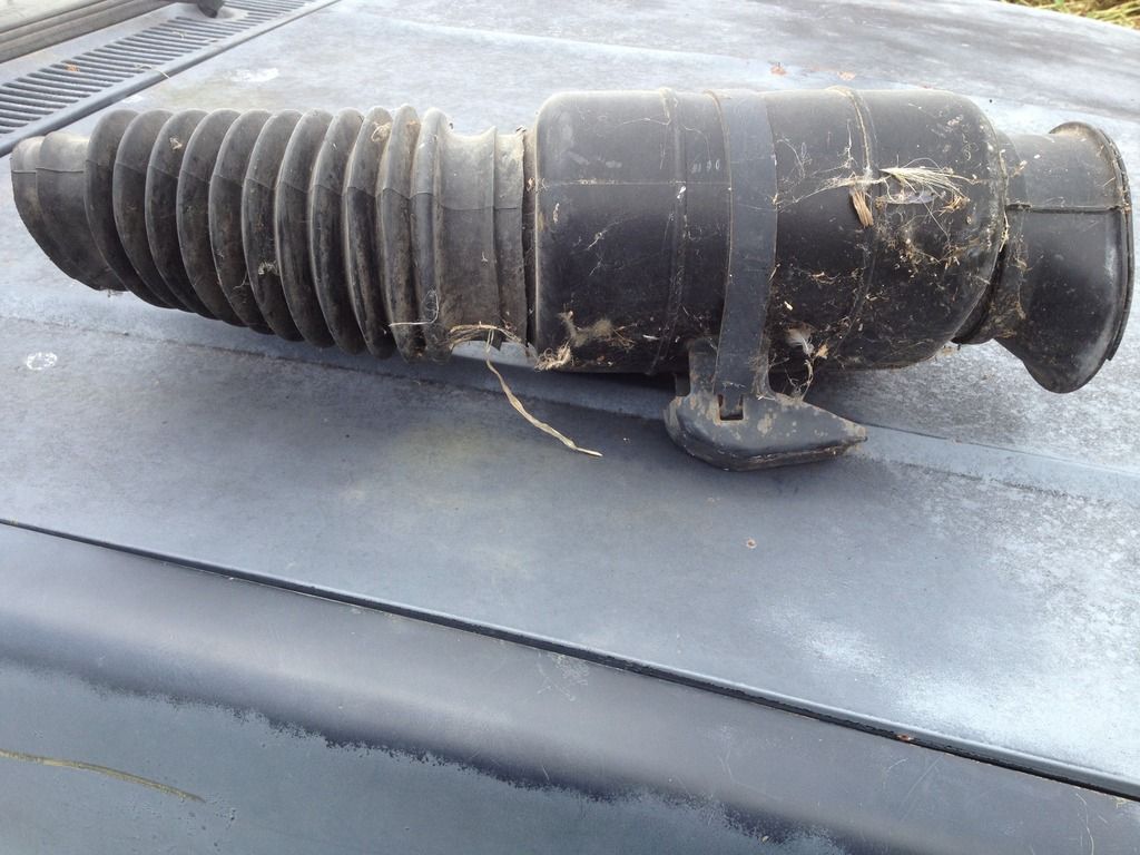

Then I remembered I had the small block ducting in my hog barn.
Should be the right size for your air cleaner.
