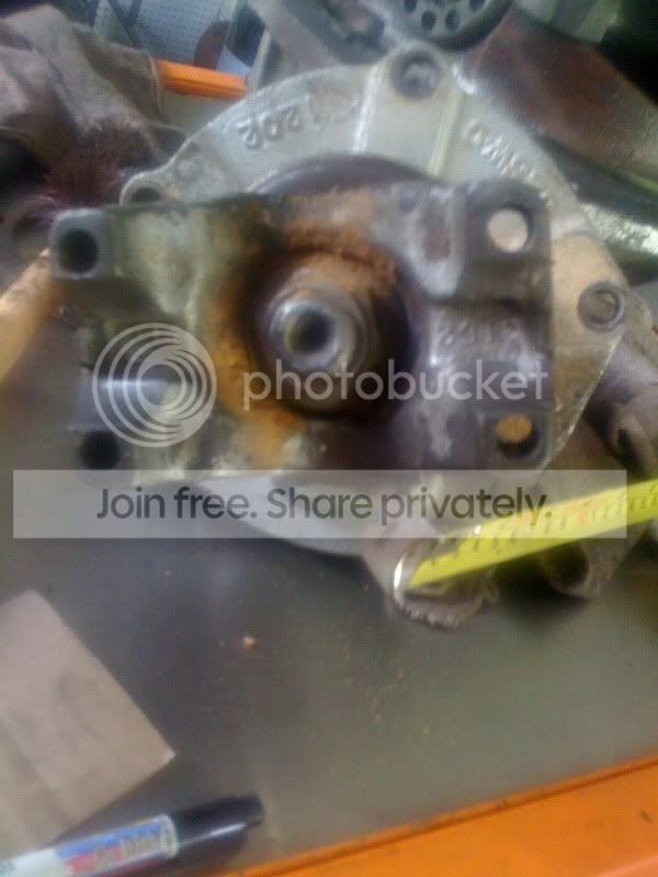

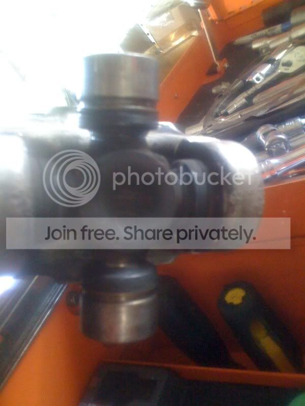

My Moser 9" for my trans am should be deliviered tomorrow.
I'm trying to wrap up all the ends that I will get snagged on before I yank my old axle out. Main problem being the driveshaft.
I traded a carb for this 3rd member, previous owner knows nothing about what yoke it has or is much help at all.... Curious thing is the factory U-joints from the trans am fit, but just the caps. When they're in the actual joint they are MAYBE a 1/16 of an inch too large. So, It's either I cut the yoke and make the factory u-joints work, or try and find an adapter u-joint, or switch yokes.
So, I'm leaning more towards finding the conversion yoke. So, I'm seeking yall's help!
Measurements:
Yoke: Diameter between "towers" is *slightly less than 3 5/8
Distance between stap holes: 1 5/8
U-joint: Distance between ends of caps is *slightly more than 3 5/8
Width of cap 1 1/16
Here are some pictures, Let me know if I completely butchered my explanation...
