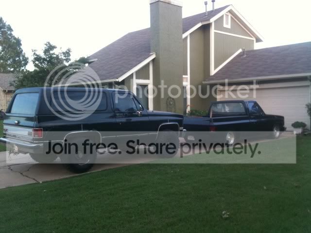

I've been around squarebodies for a long time, just never K5s or 4x4s. I've had my '87 SWB for about 18 years and have been through it a couple times.
I picked up an '89 GMC last year and have slowly been replacing simple things while learning.
Here's a picture of the two;
