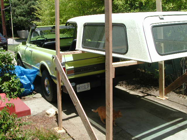

  10. 70jimmy
    70jimmy 3/4 ton status Premium Member GMOTM Winner
    Joined:
    Mar 3, 2000
    Posts:
    6,067
    Likes Received:
    333
    Location:
    Released from Pueblo, told I belong in Southpark
    I set up a way to take mine off alone. I put 4 4 by4 by 10's in the ground and bolted some heavy "L" brackets to them. I would pull in between them unbolt the top, lift it with my back and slide a 4 by 4 ontop of the L brackets from Drivers side to passenger. Same thing in the back. I had a roll bar so I would do the front and back and then drive forward to just before the roll bar hit the 4 by 4 and then I would lift the top and hold it while my wife eased the truck forward about a foot and then I put the 4 By 4 back in behind the roll bar.

  15. BobK
    BobK 1/2 ton status Premium Member
    Joined:
    Oct 5, 2000
    Posts:
    1,608
    Likes Received:
    Location:
    Petrolia,Ontario,Canada
    This is what I did to get the top off the truck.
    I slid two 2x4's inbetween the bedrails and the top.
    Then made the side frame.I lifted each of the 4 corners onto the blocks which are slightly higher than the bedrails.
    Then I drove the truck out.
    I did however get 3 other guys to help get it to the ground a couple weeks later.
    As linked to by smokkey1,I've since rigged up an electric winch to raise and lower the top on and off the truck.
    [​IMG]
  16. diesel4me
