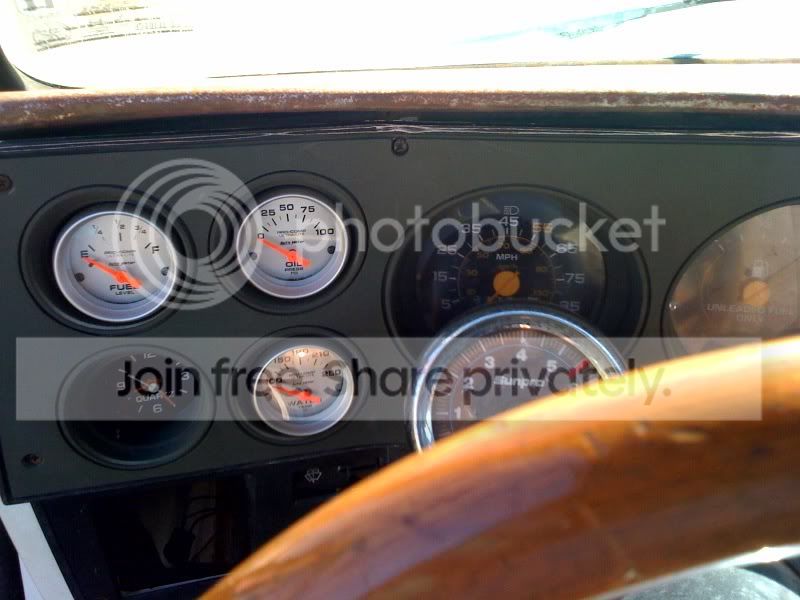

I used the 2-1/16 gauges and mounted them in the bezel I ground the bezel till they fit tight in the hole and I angled them toward me.
another option ^^^
