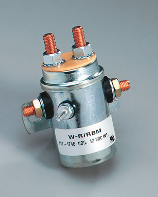

One of my techs just got a ramsey 9k from a buddy for free bc the PO tried to clean the contacts and broke one of the solenoids. After that the PO just went and bought another winch. I know the Ramsey # is a rwc-440110. has anyone found an aftermarket (napa) solenoid for it. If not I will order him a couple from summit.

I don't have any part numbers for you but the guy in my hometown that I used to rewind my flat fender jeep starter and generator carried them and sold them to me for $10. Just keep in mind it has to be a continuous duty solenoid and not momentary
Yeah, I carry them for my warn but not for the ramsey. I guess I will try and look them up like I did for it. By the way the napa # for the warn solenoid is ST402.

The only number on it is UNI0604 12V.
I can send you a couple at NO charge if that will help.
I just wanted to let everyone know that I got the solinoids a few days after the initial post and I cant say enough nice things about RAMSEY right now. I have always been a cough.....warn....cough guy but I have to admit I might just be getting a Ramsey this next time.
