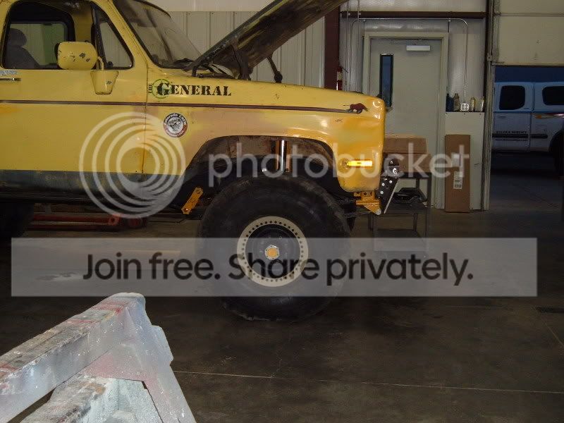

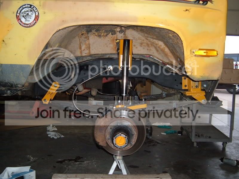

Some pics of my shocks:
The only thing I would have done different in hindsight is order them with regular poly bushing ends instead of rod ends (optional at no extra cost). The biggest pain with rod ends is that I can't weld on the truck with the shocks installed. Apparently the electrical current could pass through the shocks and ruin them.
