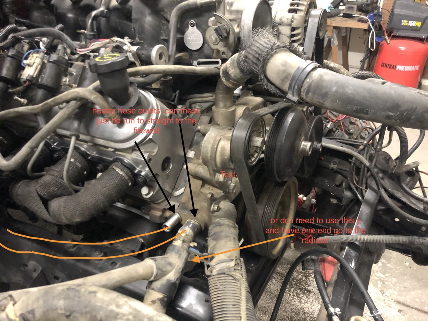

hose q by funderburgh22 posted Dec 13, 2018 at 10:56 PM[/GALLERY]i am almost done with my 1982 k5blazer 5.3 swap and need to know how to hook up the heater hoses, do they need to run through the radiator with the y hose from the smaller oulets on the water pump or can i just run the two heater hoses straight to the firewall?? i have heard both, also out of the two hoses from firewall which goes where?
The hoses can be ran directly to the firewall.
