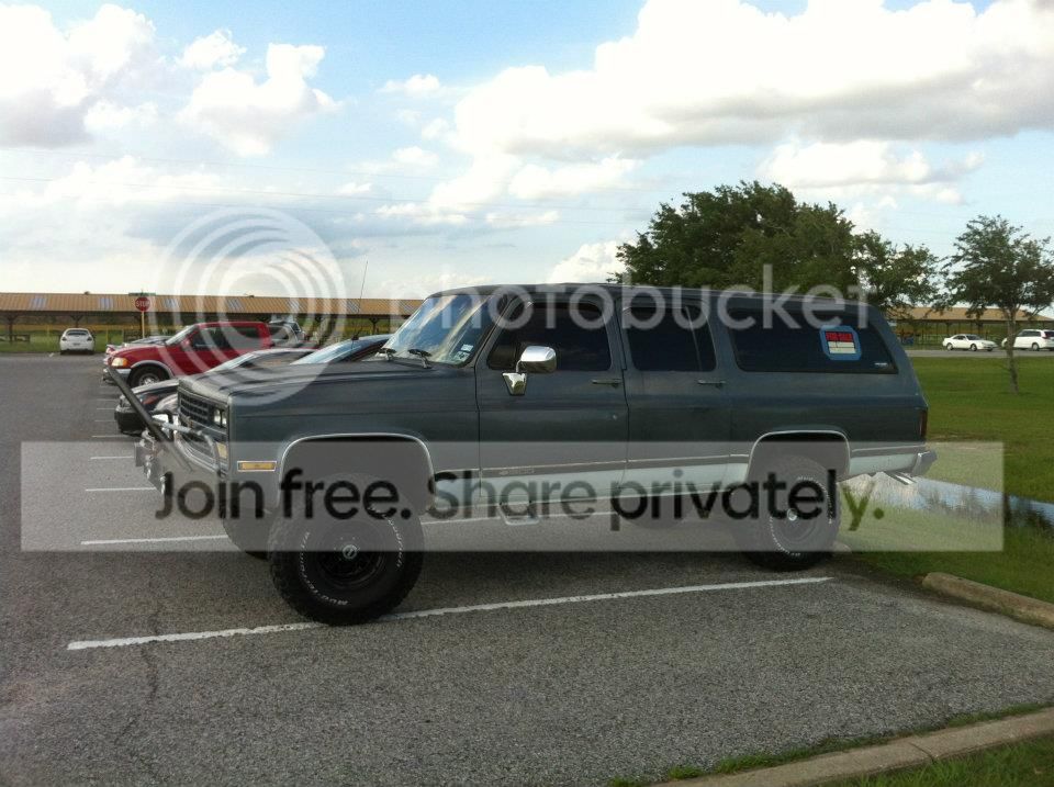

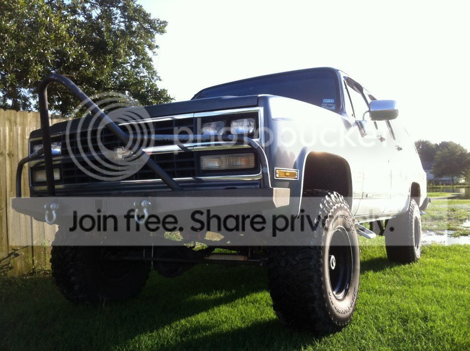

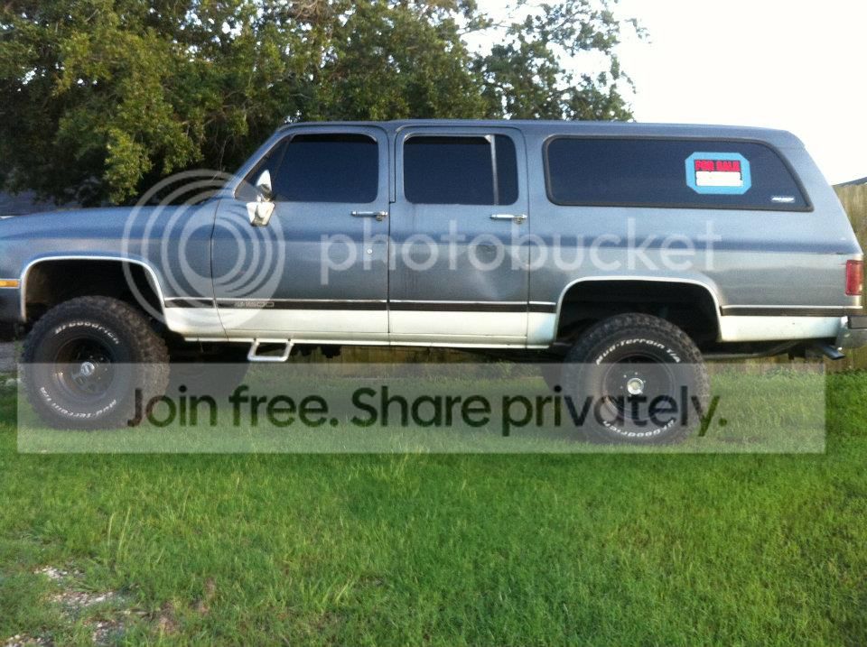

Hello to all, I am the proud owner of a 89 4x4 1/2 ton suburban and while I'm mechanically inclined my knowledge is somewhat new to the 4x4 spectrum. (spent more time under cars)

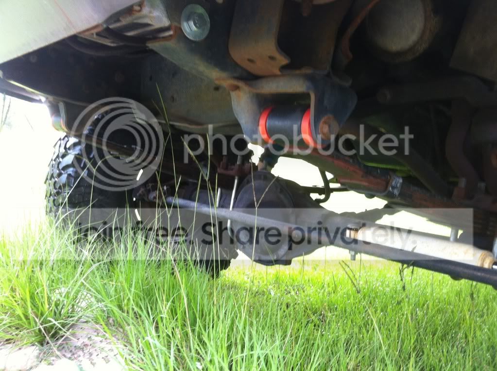

I picked this suburban up and it was said to have a 6" lift. For sure has 4" blocks in the back but not really sure if its a 4" or 6" lift. I do know there are no helper springs in the back and the springs tehmselves look a little flat in the back. Front has new springs and an extended steering rod? But unsure if the springs are 6" lift springs or if they are 4"? Truck is on 35's for reference.
Also, I am wanting this rig for some every day driving and offroad use, is that very practical with the size of this. My secondary option was picking up a wrangler and using this to tow it and have as a recovery vehicle but if it's offroad capabilities are there then I'd rather invest in one instead of two.

Any inputs on what size lift? I know it's a pro comp.

Also any ideas on what lift the truck has?

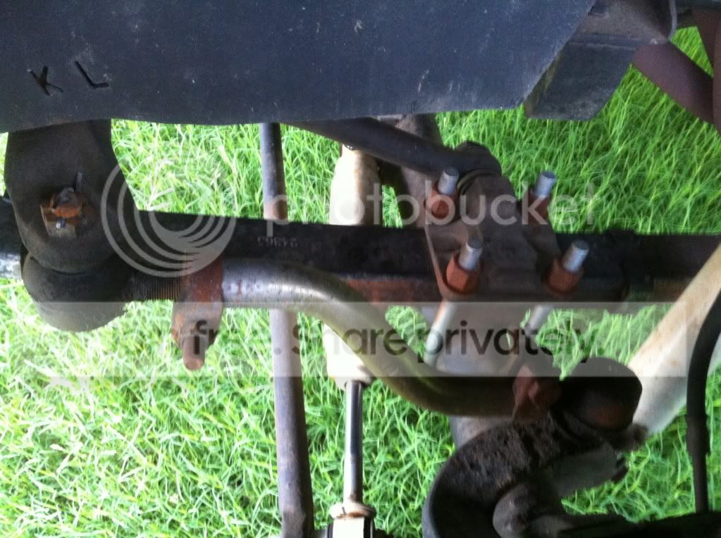

Heres a better picture of the leafs themselves:
It also has this steering bracket that was added for the lift. Works really well actually. Very little slop. I'm too newb to know what its called though:
