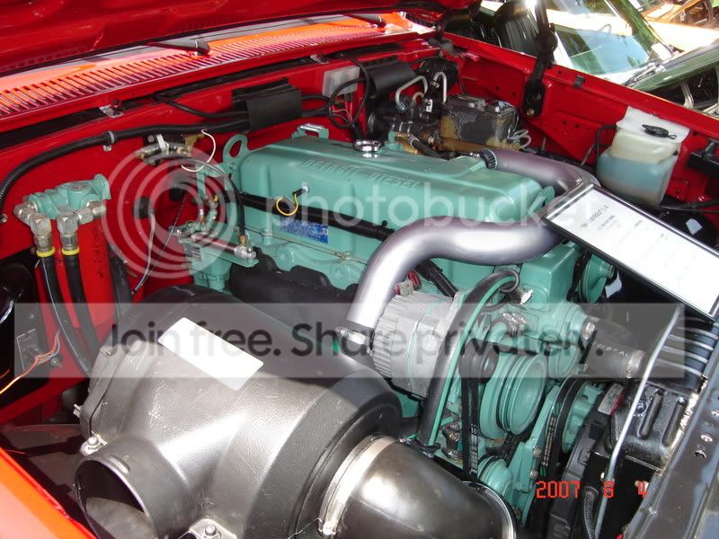

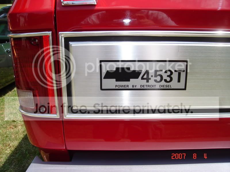

I don't know, but check out this truck I photographed at a local car show:
