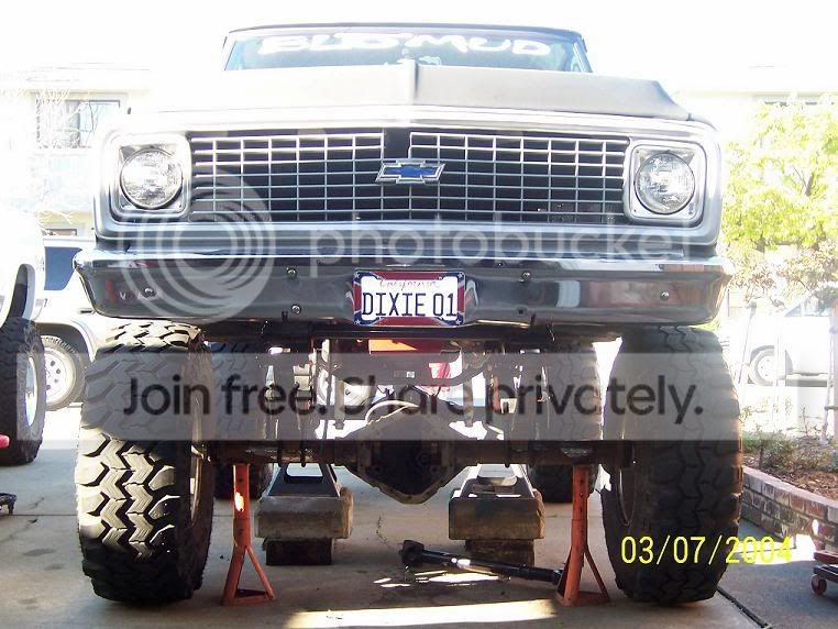

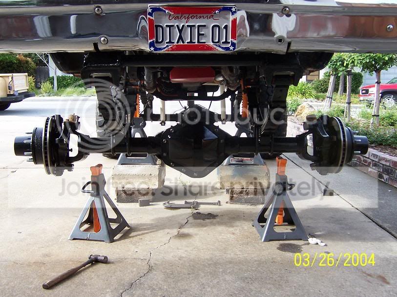

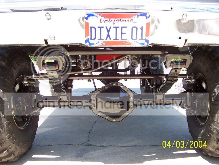

Yeah no problem! The only pics I have are in the link in my sig. All of the rest got deleted on my computer, and I dont know how to get them back. I tried a search to find all the info, because I've posted it before, but for some reason im coming up empty handed. Its a 14b centersection with new tubes and D60 knuckles out. Same width as a D60. The pinion is indexed up and the caster is at 8*. THe tubes are the same ID as a D60 but the OD is bigger then a 14bff, so there pretty freaking thick. I havent worked on it much, because theres other things at the moment. I still need to get inner shafts made and work out my T Case. Any other questions, let me know!

no worries about the diff hittin the oil pan? or no hard core off roadin in the future for this truck?
Well it is a ways away, and when I do coilovers, it will be even FURTHER away!:D I want to take it to the rubicon. But, no, its not gonna get beat to hell, its been there when it was little! I want a second gen to beat, lol!
