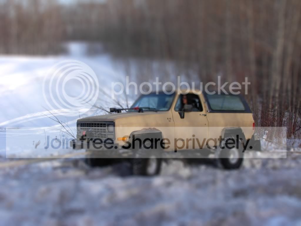

i mounted mine on my hood, and don't like it. the hood supports it no prob, i just drill up through the space in the cross supports where they y.
you have to sit pretty erect to see the corners of your front clip and im 6'4".
the wife bought me a bumper mount kit and i couldn't make it work because of the winch and in the back i didn't want to wipe it on a departure.
but as they say hind site is 20/20, day after i mounted the dam thing i seen a pic here of a better way lol.
that way is by mounting in the tub over the wheel well.
just drill some holes where the box lips over and just use the bolts not the silly brackets.
the same can be accomplished with washers to get the correct backspacing as the brackets.
only pic i have sry
