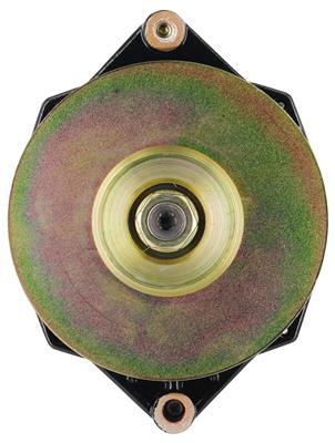

I know there are quite a few hi output alternator threads out there, but i couldnt find one that explained wether or not you had to fabricate brackets to install one. Is there a 140 amp or higher that you can buy and install without all the hassle of fabricating brackets and stuff like that. If so Can you let me know where i can pick one up? Thanks for the help guys

If you want 140 amps I would look for a larger alternator like the 12SI or a CS144. The bigger case improves cooling. You can get a 140 amp 10SI which would be a drop in replacement, but it will run hotter probably shortening its life. If you can fab your own tensioning brackets then the 12SI and CS144 will fit in without too much work.
Do a search on this subject. There is a lot of information and even Gm part numbers for the wire harness adapter. I have a 140 amp that is an application for the pontiac vans that has rear A/C. I had to relocate the upper bracket hole where is mounts onto the intake manifold. I also had to modify the lower backet that attaches to the head and the alternator. Relocate the hole as well. This was one of the best mods I have done cause I plow with this and use a lot of lights at the same time.

i had my grandad check and i found out that i have a 10si, i checked that link that opfor gave me and im going to go ahead and order that one today. Well thanks for all the info guys!
The link took me to a page with a bunch of stuff. Which exact model and that was for your 76 right? Which case style do we have? Tha part numbers I'm looking at are the PWM-57294 or the PWM-47294. One is black finish, one natural, both 140 amp.

It's the 10si case style and part # PWM-57294. The black one. And yes, it is in the '76. :D
