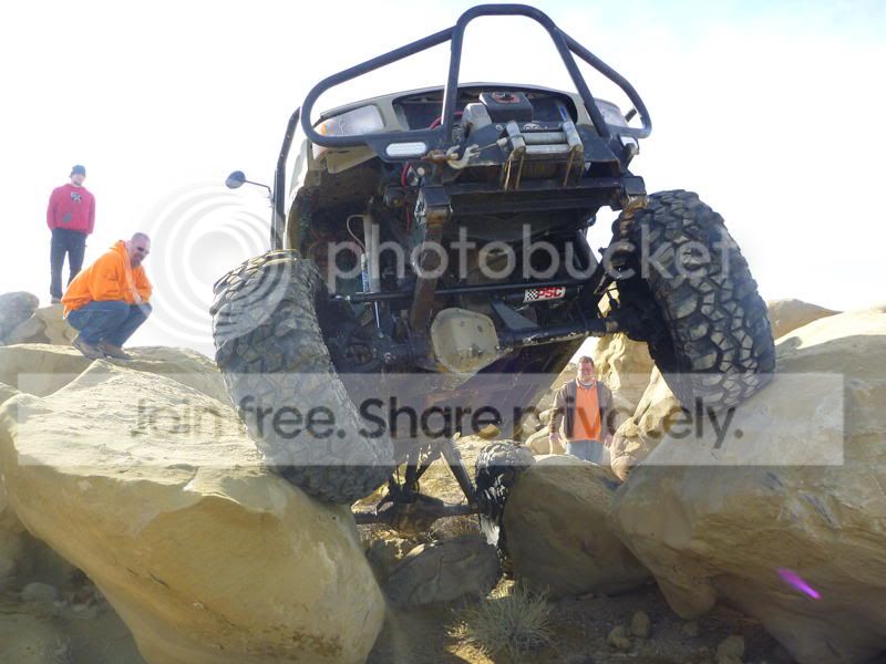

I have reverse high steer but I bet you could make it work for conventional high steer as well. I used a WFO ram mount on the tube and a simple tube clamp with some tabs I welded on to grab the tie-rod.
Works well and packages tight. I barely have 4" of lift and it all clears.
Here was my old setup. Was full hydro but would work fine for assist too. I prefer to make my cylinder connection near the end of the tierod so its not trying to push and bend the middle of tierod as likely.
