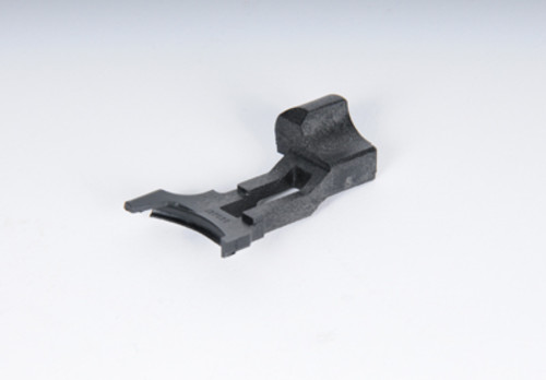

Hmm, I don’t really see where you are missing anything. It looks like everything you need is there. The dimmer rod can be a real sumbish to get properly aligned to the plastic actuator piece which can cause issues. Then again, maybe that plastic piece is broke or something??
In any event, this piece below is the most common part that breaks and can cause dimmer problems. The part number is an AC Delco D844

The pictures is not from my car, it its what I can find looking in chevrolet forums.
Thanks to you, I have now found the AC Delco D844 on Ebay. And further more also a US165L repair kit containing the two parts.
Thanks a lot Larry.
