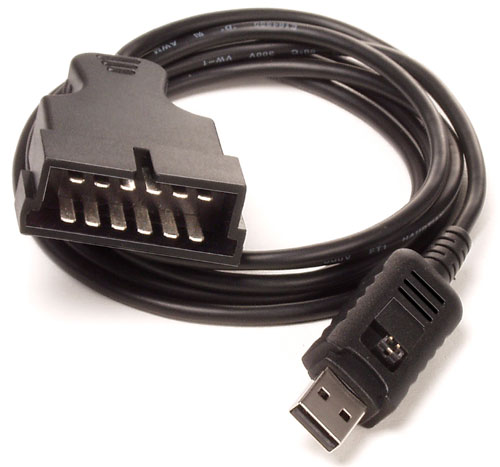

Another thing you could do is go to this link https://www.tunerpro.net/. Download TunerPro, install it onto a laptop (if you have one). Then you need to get a data cable (pictured below), and the proper definition files for your ECM here...http://www.tunerpro.net/downloadBinDefs.htm#GM, and then you can interface with your ECM to see what your engine is doing.

1-Ton, to the best of my knowledge I have the standard TBI. I installed tuner pro and purchased the usb adl cable about six months ago, trying to find what was causing the rough idle. I have the data streams from open/closed loop, with two 20 minute drives. At the time my voltages for the o2 sensor were off, so I replaced that, still no change. The stalling just started happening recently so I'm trying to figure out if I have two separate issues. One of the challenges I ran into using tuner pro was deciphering some of the data streams and making sure I had the correct bin for my setup, as there is a learning curve. I'll take a look at your video and give it another shot.
