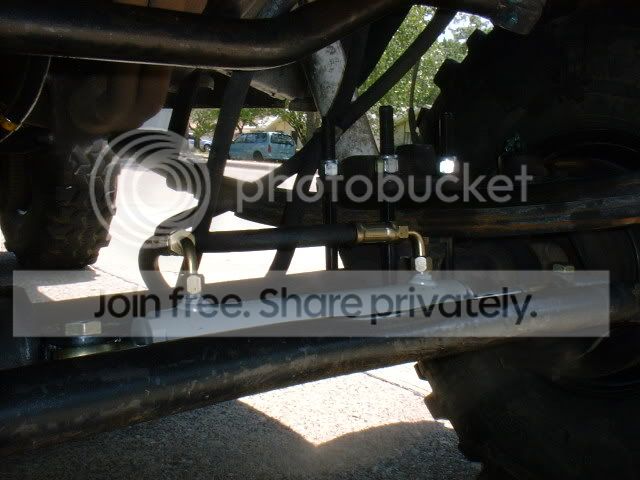

    I run ORD crossover, good stuff. It is easier to mount hydro assist to the plain tie rod location, but highsteer assist can be done by making a bracket ontop of the axle to mount the assist onto level with the tierod.
    How i have my ram mounted-
    [​IMG]
