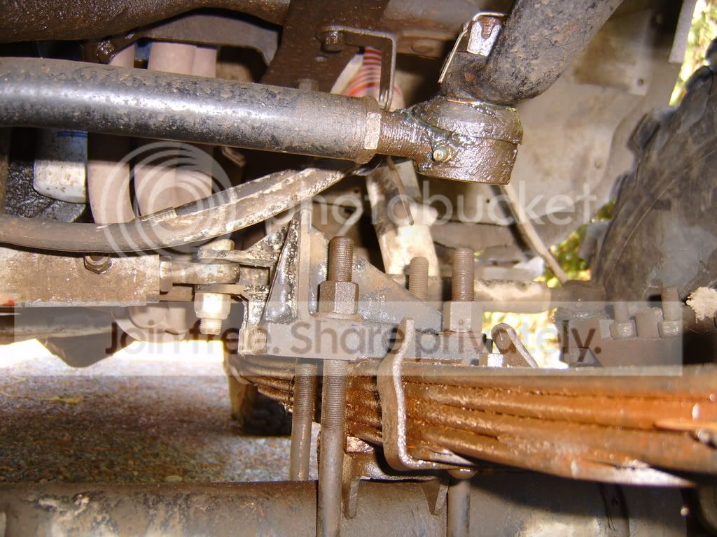

Just gotta use your imagination. Here's mine dampener with reverse high steer off the spring plate.

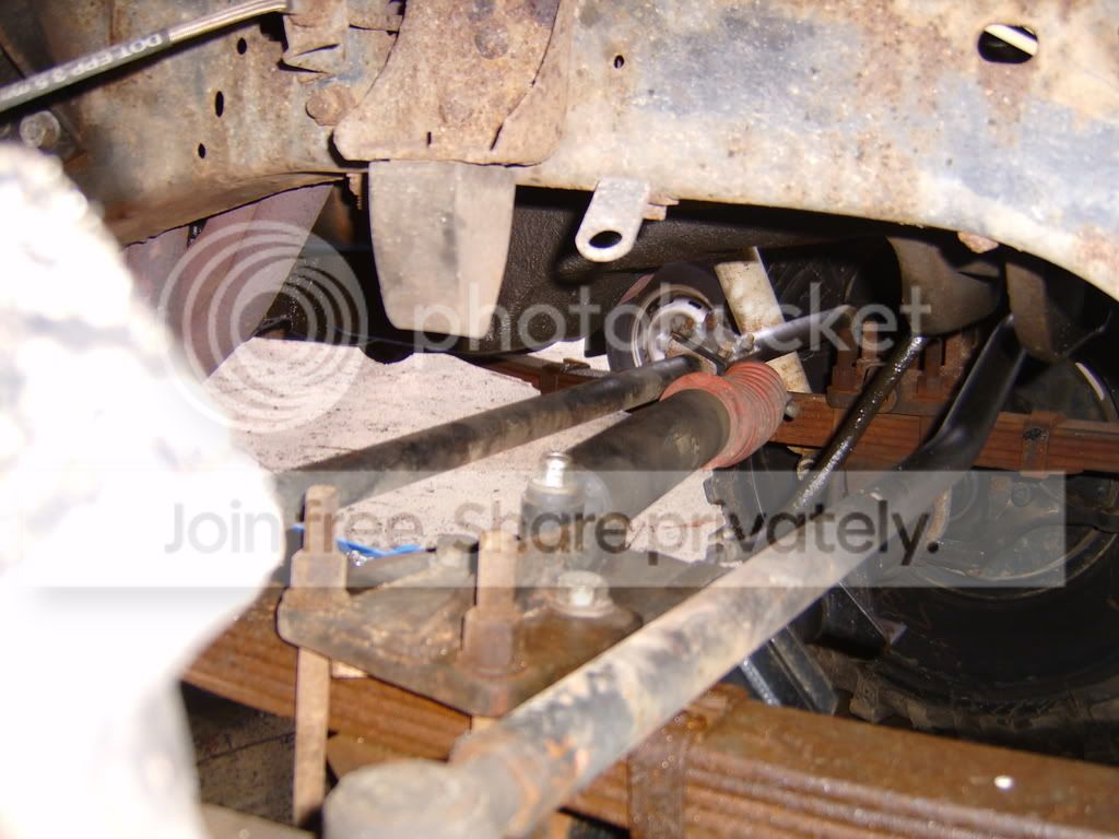

Then here's my hydro assist with reverse high steer. Pretty much the same as a dampener just a little more beefy.

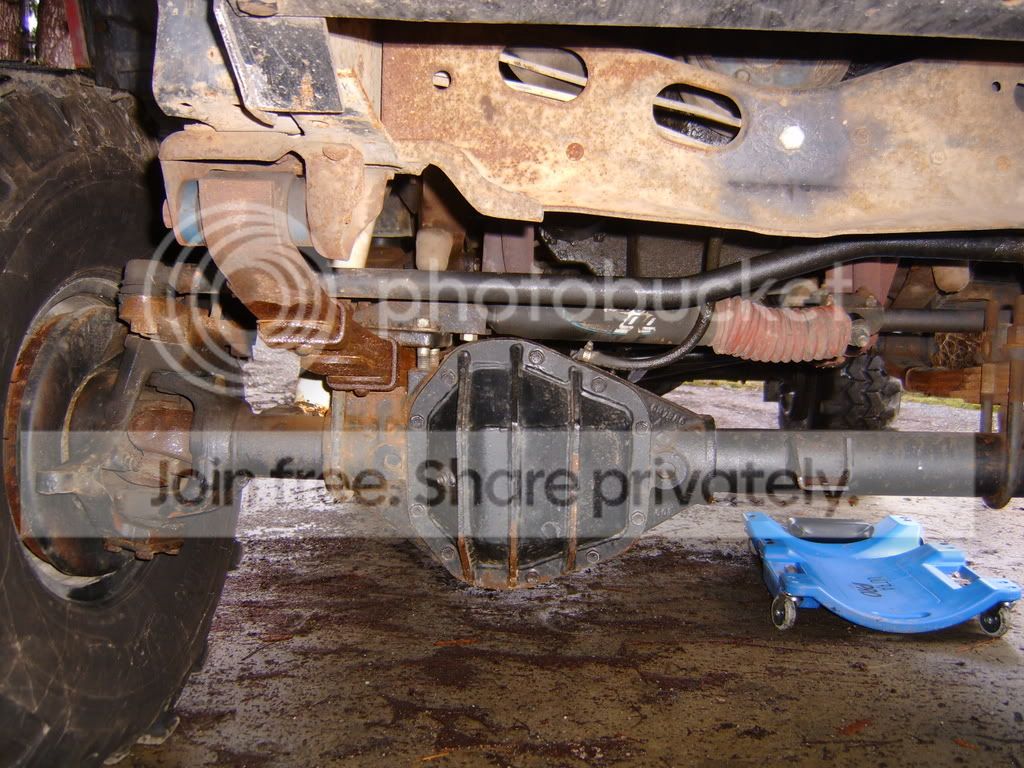

I have crossover / highsteer and hydro assist and it is far smoother than the stock setup was. No issues at all at interstate speed and above.:whistle:
With 7 inches lift, a shackle flip, zero rate, and 37 inch krawlers. I never had just crossover without high steer so can't offer input on that route, but I don't see that making a difference either.
