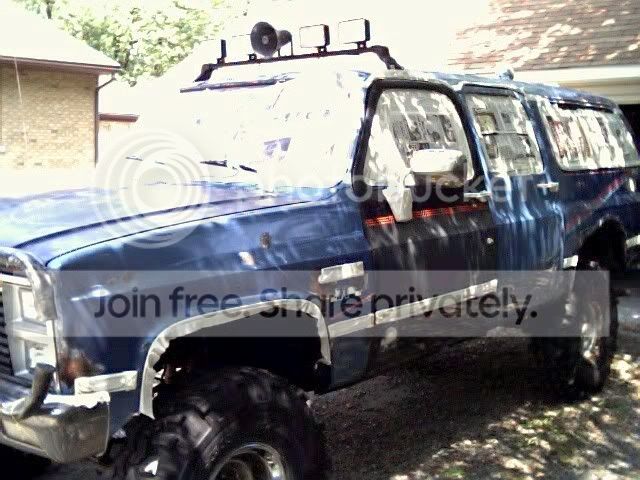

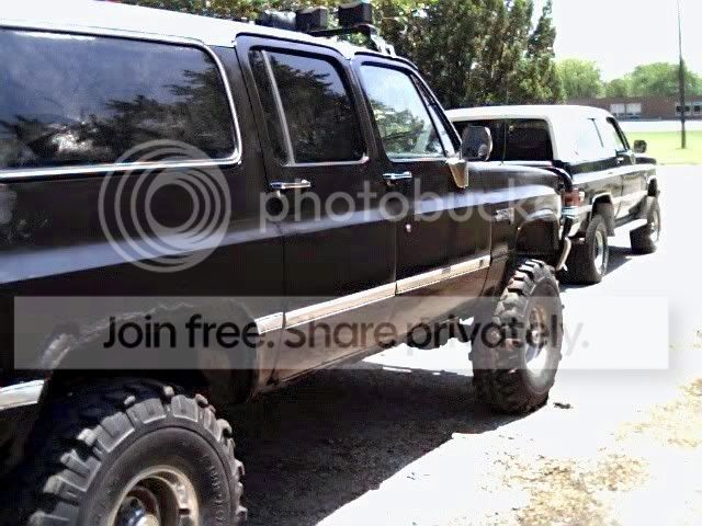

I painted this with a roller and brush with rustoleum paint from home depot
It held up great for several years. Only two coats. Looked good from far away but when you got close it looked like it had bad orange peel. I didn't wetsand or polish it. But I can tell ya water would bead right off!

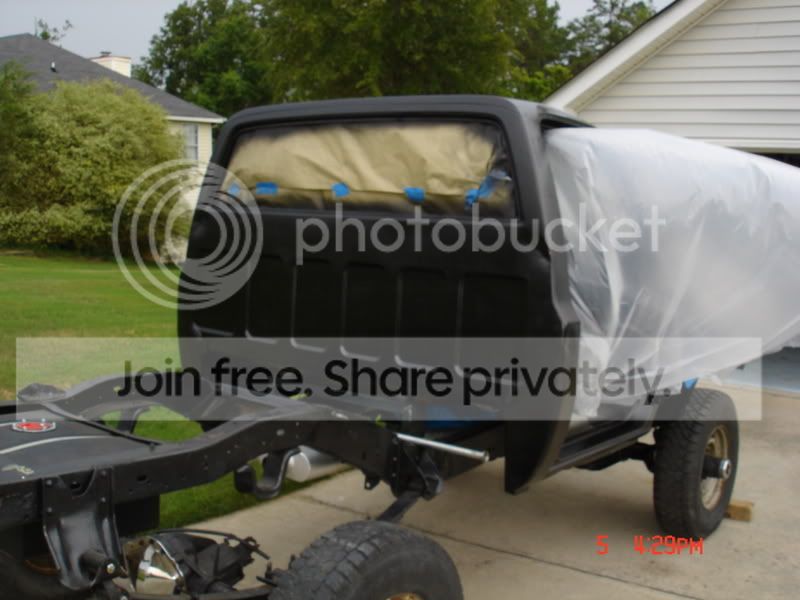

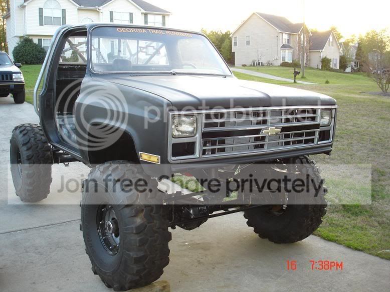

I sprayed my 77 when I built it 2 coats red, and 2 coats of thick rustoluem white. Looked real good when I was driving.
I never wet sanded any of it...Went in the mud once before I took it apart and sold it...Damn I spent a long time trying to wash mud out of unsealed paint...haha
