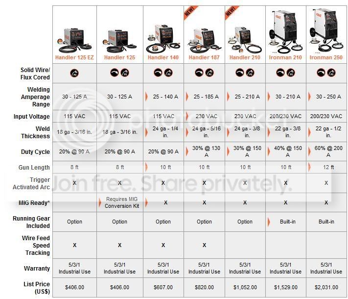

I've been eyeing the Hobart Handler 210...
It seems like a well rounded unit for what we plan to do... so here's my question... should I save the $200 and go with the 187 (only difference I can see is it only welds up to 5/16" instead of 3/8" like the 210) or is it like a trailer... just go big from the get go?
Are there other suggestions for something with similar features from say Lincoln or someone else?
The 210 has the option of a spool gun. I have the 180 (old version of the 187) and I love it. They added three more voltage settings from the 180 version.
Personally I think that the 187 would do everything for a normal user.
That's kind of what I was thinking... we're talking a 16th of an inch difference in welding capabilities...
We had a 175 where I used to to work Old Old Version of the 187 and I have a 180 at home. They do everything you could wish for them to do. That old 175 got used ALOT and never complained.
I run a miller 180 and it welds 1/4'' plate easily in one pass. You can always make more than one pass on thicker stuff.
I was going to buy the H187 but the miller came on sale for 100 more. These welders should do anything you need to short of a full time welding shop.
the 210 has a bigger dutycycle. thats what id go with. the hobarts are built my miller so they are nice machines.

Yeah I noticed that but didn't think it'd really be a factor for the type of work we'd be doing in the garage (weld on steering brace, bumpers, sliders, etc.)
Is it worth the extra $200+?

For what it's worth, I've only hit the duty cycle limit one time. I was welding 1/4" plate for the winch mount of my tube bumper.
It seemed like I was welding forever when it tripped. I am more aware of the limit and it hasn't slowed me down or tripped since.
It's not a factor unless your primary weld is 1/4" plate.
