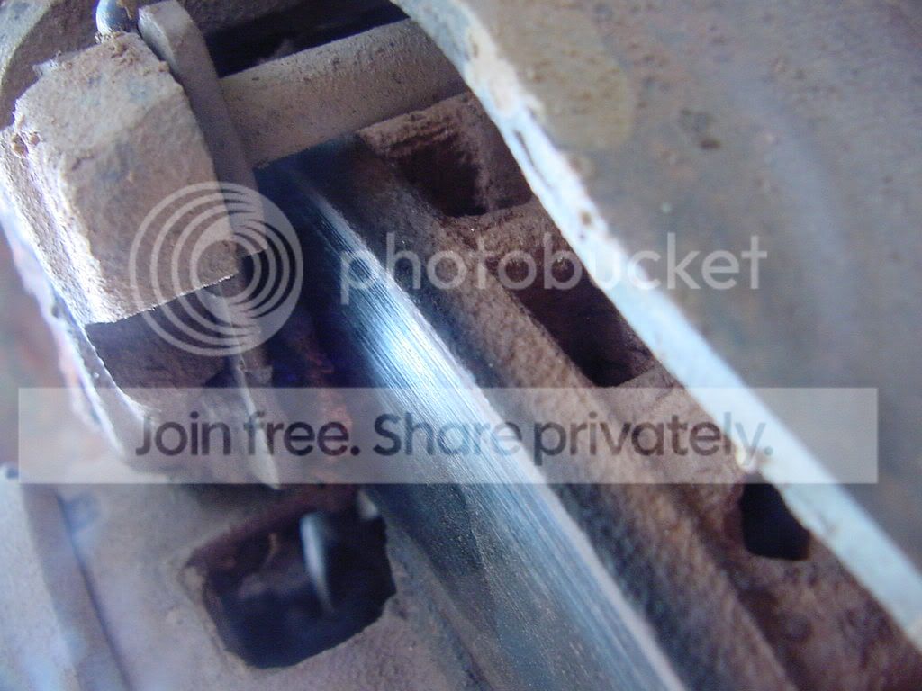

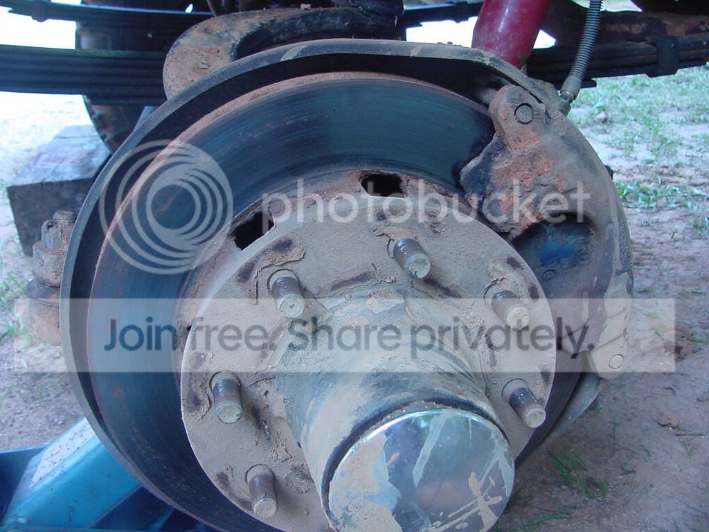

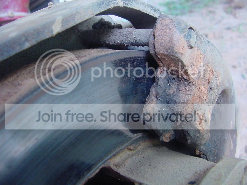

EDIT again.. pics.. it might be hard to tell from the pics, but the pad is touching the rotor. I can still turn the rotor by hand, but it does have some drag from the brake pads... so I assume this caliper is locked, and its the culprit of spit sizzling drive flange and caliper?

stuck caliper, time to replace it now. Pretty sure the seals are melted.

if the caliper was locked, I wouldn't be able to turn the rotor by hand, right?
You have a 10 bolt with dana 44 calipers. It's just a screwed up transitional year. 10-bolt calipers normally have a 10mm banjo, and dana 44's have a 7/16 banjo. That's pretty much the only difference. I would order new calipers for a 75 just to make sure you get D44 ones, since that's what your brake lines are set up for. The funny thing is, if you had replaced your calipers when you installed your brake lines, you could have ordered '80 calipers and avoided modifying your brake lines. :rolleyes: I think that 80's calipers were cheaper than the older D44 calipers when I bought mine earlier this year.:doah: And of course now if you get a D60, it'll probably take 10mm bolts, so you'd have to get new brake lines again. :crazy:
And yeah, if your caliper was seized, I wouldn't think you'd be able to rotate the rotors by hand. The only seized calipers I've dealt with had to be lubed like crazy and beat to hell with a BFH just to get them off. Maybe the heat was just from a seized bearing? Did you get anything apart yet? It might be ugly in there, I'd hate to think what your spindle looks like.
