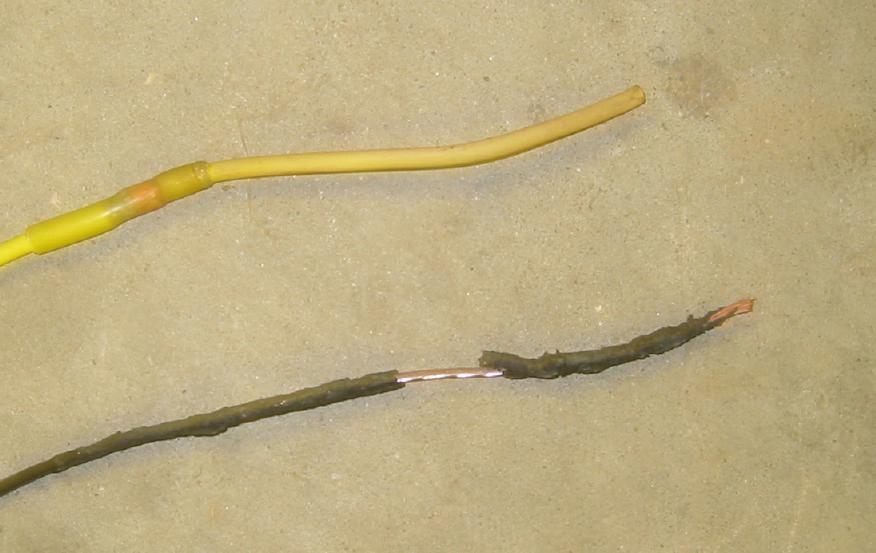

Holy smokes, Batman. Wiring differences
73k5blazer
End the H1B Program!
Dec 28, 2001
5,405
689
The Rustbelt
In case anyone was doubting me, here is the difference in quality SXL crosslink rated wire, and standard Napa "Primary wire". I placed each 14gauge wire directly in front of my 55.000 BTU Reddy Heater for 30 seconds. The primary wire was flaming in 3 seconds. The SXL made the popcorn sound it's supposed to, discolored a little, but never melted or exposed any of it's wire. ANd it's still flexible! This is why SAE says no GPT or primary wire in an engine compartment or within 8" of exhaust.
Any questions?
Next test, I'm going to take a piece of each in 10ga, and short a car battery, see how it holds up from the inside.
