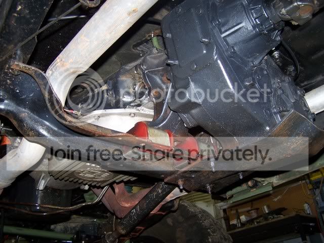

Was thinking of making a homemade tranny cooler. Only concern is this appears that it might hold a few more quarts of fluid and that the pump might have a hard time pumping the fluid thru it. What do yall think?
I dont think it would be any different than running a deep trans pan.
Might make the tranny too cold. Maybe installed with one of those thermostat thingys.
As long as it isn't a restriction, and there is a smallish pressure drop across the cooler, I don't see a problem with it.

That cooler isn't much bigger than the stacked plate I use. I plumbed it thru the aux cooler first, then thru the stock cooler. The added volume isn't a problem. Only likely problem would be if it was too restrictive and cut down total flow thru the cooler system.
Coolers follow the same rules as resistors for total flow resistance when in series or parallel. Stringing a bunch of coolers together in series is likely shooting yourself in the foot, but two (particularly with the manifolding of that one in the pic) in series shouldn't be any trouble.

Is that an evaporator? If it is, it seems to me that regardless of the fitting size, it would restrict the flow of transmission fluid. Also, automatic transmissions are just like engines in that they have a temperature range they must be kept in for correct operation and performance.
Given that it's a hyd cooler I've no doubt that it can flow more than enough fluid to not be a restriction. If you can get it clean enough I'd say give it a try. And monitor trans fluid temp to see how well it works.
