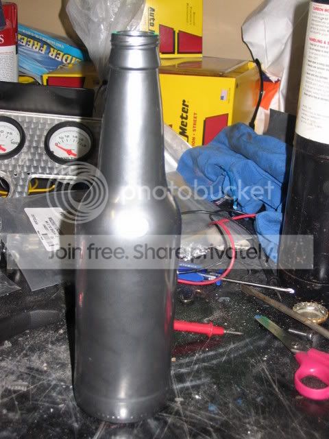

You can do glass this way, too. :D
We had a bunch more too. Seemed the more we drank the more powdercoated bottles we ended up with. :haha:
